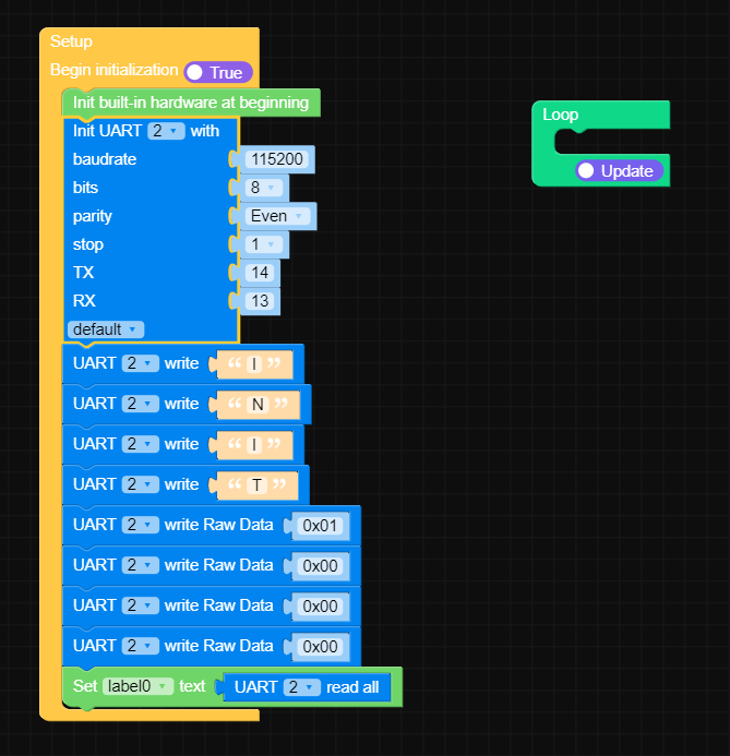

<p dir="auto">it is hard to tell what is going on as I do not have this sensor and I cannot test myself.</p>
<p dir="auto">Yes, I think it is possible that the sensor is waiting for the INIT command before doing / sending anything.</p>
<p dir="auto">I also noticed that the Micropython code you posted doesn't seem to match the posted UIFlow blocks. In the Micropython code I can see two UART init lines, both not using the correct RX and TX pins.</p>
<pre><code>uart2 = UART(2, baudrate=115200, bits=8, parity=None, stop=1, tx=9, rx=10, rts=-1, cts=-1, txbuf=256, rxbuf=256, timeout=0, timeout_char=0, invert=0, flow=0)
uart2.init(baudrate=115200, bits=8, parity=0, stop=1, tx=32, rx=33, rts=-1, cts=-1, txbuf=256, rxbuf=256, timeout=0, timeout_char=0, invert=0, flow=0)
</code></pre>
<p dir="auto">Thanks<br />
Felix</p>

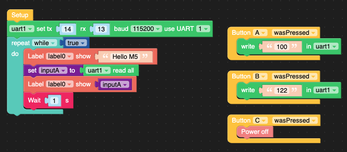

<p dir="auto"><img src="/assets/uploads/files/1693411231580-197bc757-fe07-42bc-b57a-f4338187932c-image.png" alt="0_1693411246429_197bc757-fe07-42bc-b57a-f4338187932c-image.png" class=" img-fluid img-markdown" /></p>
