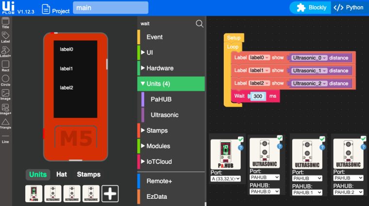

Today I tried to connect 3 ultrasonic units (I2C) to the StickC Plus controller (UIFlow 1.12.3).<br />
One ultrasonic unit directly connected to the controller works correctly. When I used the PaHub unit then ultrasonic units are not detected. I did some tests and I see that the ultrasonic works fine through PaHub, but only if I set PortA in the port settings of the ultrasonic unit (the same port is set for PaHub). If I select the port PAHUB - PAHUB:0, then the ultrasonic unit is not detected. What am I doing wrong?</p>

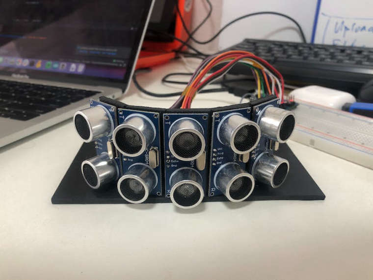

<img src="/assets/uploads/files/1694186492443-_5jbk6xmvzn-resized.jpeg" alt="0_1694186497256__5jbk6xmVZn.jpeg" class=" img-fluid img-markdown" /><br />
<a href="https://www.hackster.io/user04650005/ultrasound-sensor-array-with-the-hc-sr04-f7108f" target="_blank" rel="noopener noreferrer nofollow ugc">https://www.hackster.io/user04650005/ultrasound-sensor-array-with-the-hc-sr04-f7108f</a></p>
]]></description><link>https://community.m5stack.com/post/22190</link><guid isPermaLink="true">https://community.m5stack.com/post/22190</guid><dc:creator><![CDATA[gavin67890]]></dc:creator><pubDate>Fri, 08 Sep 2023 15:24:41 GMT</pubDate></item><item><title><![CDATA[Reply to StickC Plus + PaHUB + 3 Ultrasonic I2C units on Fri, 08 Sep 2023 15:16:35 GMT]]></title><description><![CDATA[<p dir="auto">I tried the example in the following documentation, but I think it is out of date because the blocks are not available as shown in UIFlow <a href="https://docs.m5stack.com/en/uiflow/advanced/i2c" target="_blank" rel="noopener noreferrer nofollow ugc">https://docs.m5stack.com/en/uiflow/advanced/i2c</a> (<a class="plugin-mentions-user plugin-mentions-a" href="/user/m5stack" aria-label="Profile: m5stack">@<bdi>m5stack</bdi></a> can this be refreshed please).</p>

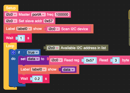

<p dir="auto">Basically, I wanted to try and setup an I2C ultrasonic module from vanilla blocks, without Add/+ing the module and in accordance with this Arduino code <a href="https://github.com/m5stack/M5-ProductExampleCodes/blob/master/Unit/ULTRA/Arduino/ULTRA/ULTRA.ino" target="_blank" rel="noopener noreferrer nofollow ugc">https://github.com/m5stack/M5-ProductExampleCodes/blob/master/Unit/ULTRA/Arduino/ULTRA/ULTRA.ino</a> and this <a href="https://www.sgbotic.com/products/datasheets/sensors/sr04_i2c.py" target="_blank" rel="noopener noreferrer nofollow ugc">https://www.sgbotic.com/products/datasheets/sensors/sr04_i2c.py</a> for guidance/inspiration.</p>
<p dir="auto">If I could be confident in the sensor, then maybe move back to the hub, then back to multiple sensors following the Arduino and converting back to vanilla blocks, something like this <a href="https://dronebotworkshop.com/multiple-i2c-bus/" target="_blank" rel="noopener noreferrer nofollow ugc">https://dronebotworkshop.com/multiple-i2c-bus/</a></p>
<p dir="auto">I also tried the "Scan I2C device" block, which doesn't find address of Ultrasonic (0x57) at freq 400000 - fine for ENV III [0x44, 0x70] and PaHub [0x70] – ENV III on its own definitely scans as two addresses. freq reduced to 100000 it finds the ultrasonic address.</p>
<p dir="auto">If I try and use the "Available I2C address in list" block I get I2C bus error (19) message (StickC and Core2), any help appreciated on why.</p>
<p dir="auto">I'd really like to figure this out as I2C ultrasonic sensor arrays would be extremely useful for driving vehicles.</p>
<p dir="auto"><img src="/assets/uploads/files/1694186085183-screenshot-2023-09-08-at-16.14.52.png" alt="0_1694186101089_Screenshot 2023-09-08 at 16.14.52.png" class=" img-fluid img-markdown" /></p>

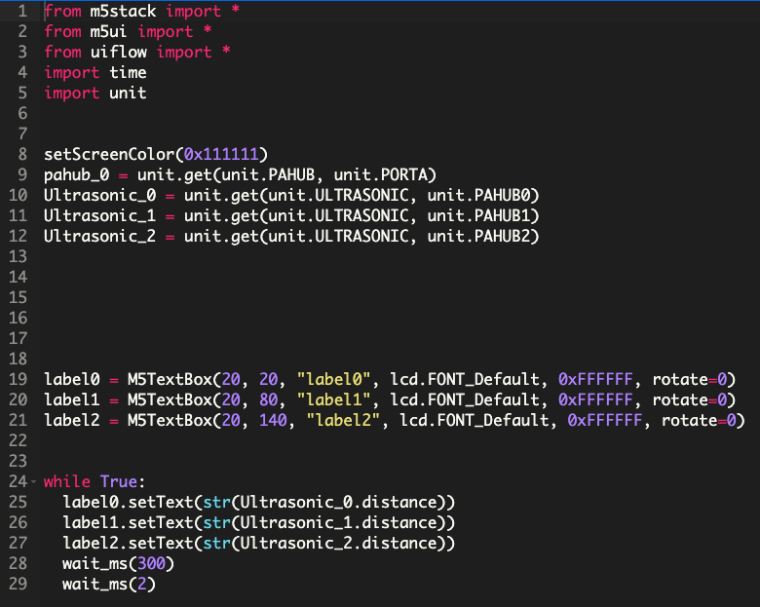

<img src="/assets/uploads/files/1693979493477-screenshot-2023-09-06-at-06.46.52-resized.png" alt="0_1693979509477_Screenshot 2023-09-06 at 06.46.52.png" class=" img-fluid img-markdown" /><br />
<img src="/assets/uploads/files/1693979897183-screenshot-2023-09-06-at-06.57.32-resized.png" alt="0_1693979912312_Screenshot 2023-09-06 at 06.57.32.png" class=" img-fluid img-markdown" /></p>
]]></description><link>https://community.m5stack.com/post/22161</link><guid isPermaLink="true">https://community.m5stack.com/post/22161</guid><dc:creator><![CDATA[gavin67890]]></dc:creator><pubDate>Wed, 06 Sep 2023 06:00:32 GMT</pubDate></item><item><title><![CDATA[Reply to StickC Plus + PaHUB + 3 Ultrasonic I2C units on Tue, 05 Sep 2023 22:21:28 GMT]]></title><description><![CDATA[<p dir="auto"><a class="plugin-mentions-user plugin-mentions-a" href="/user/robot_alf" aria-label="Profile: robot_alf">@<bdi>robot_alf</bdi></a> That's encouraging.<br />
I take that label0 is Ultrasonic_0<br />
, label1 is Ultrasonic_1<br />
, label2 is Ultrasonic_2<br />
What happens if you complete the three unit ultrasonic set (by adding (Add/+) two more Ultrasonic units)?<br />
Have you tried increasing the Wait?</p>
