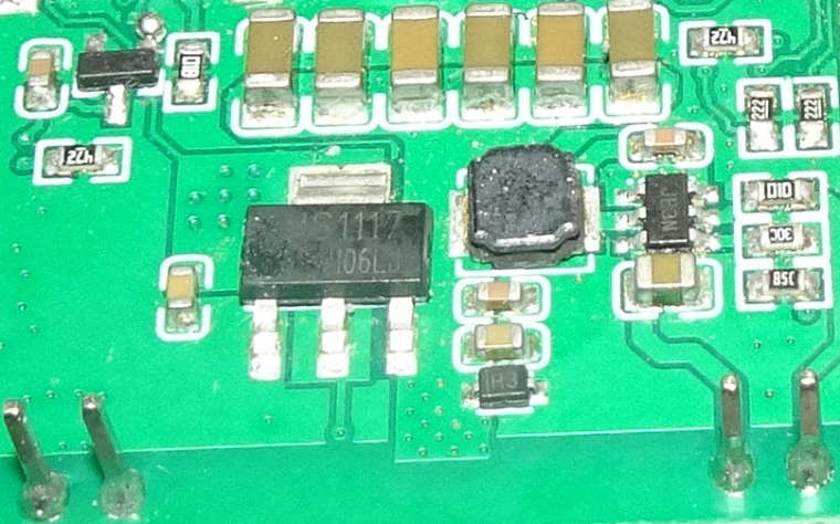

<p dir="auto">I am currently experiencing intermittent problems with this module. I was able to narrow it down to the power supply. Could you please confirm/refute my understanding of the module's power supply?</p>

<p dir="auto">looking at the picture you've posted again I don't think the AMS1117 is the regulator for the SIM7600G-H. I think the 6 pin IC labelled JB3N (or so) on the right side is - the traces from Vin also go there. The output of that IC goes through the coil (squarish black thing) which is then feed into the AMS1117 pin 3. So my guess is that the SIM7600G-H is actually powered from the 3.75 V coming out of the coil. This would almost match the recommended voltage of 3.8 V.</p>
<p dir="auto">Note: I am obviously guessing here as I do not have this particular green board to verify myself.</p>
<p dir="auto">While we do not have the schematic of the green board we do have the <a href="https://www.waveshare.com/w/upload/f/fd/SIM7600_Series_Hardware_Design_V1.02.pdf" target="_blank" rel="noopener noreferrer nofollow ugc">pinout</a> of the SIM7600G-H so you could double-check (if you haven't already) what the actual voltage is that goes into VBAT (pin 38, 39, 62, 63).</p>
<p dir="auto">Note: if my above assumptions are correct then I don't know what the AMS1117 is doing and what it's output voltage is needed for. Well, maybe it's used for the active GPS antenna.</p>

<p dir="auto">One more attempt to appeal to your sense of responsibility. I powered the SIM7600G-H Module with 5.0V, between Vin and GND. I measured the following voltages between the pins of the AMS1117 voltage regulator and GND:</p>
<p dir="auto">1: (GND/Adjust): 0.0V<br />
2: Vin: 3.75V<br />
3: Vout: 2.85V</p>
<p dir="auto">If the SIM7600 modem is connected to the output of the regulator, which is assumed, then the minimum operating voltage is significantly undershot.</p>
<p dir="auto">Please respond to these findings and publish a diagram of the green piggyback circuit with the SIM7600 modem. Of particular interest is the connection between Vin and the input of the regulator. Why aren't the 5.0V input voltage making it to the input of the regulator?</p>

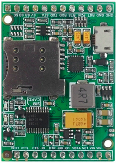

well, what can I say but: That's weird.</p>
<p dir="auto">Now, just look at M5's pictures of the module. On their doc site, it's yours. On the shop site, it's mine...</p>
<p dir="auto">I think we get to the core of the problem. I just measured the voltage, when USB is connected on the M5stack Core Basic 2.7, at the input of ther regulator: 4.3V ! At its output it has 2.8V. That's way off the 3.4V limit.</p>
<p dir="auto">So the issue is not so much the type of regulator, but the question whether or not we can use internal power supply or not. My understanding of M5's specification is that external power supply is explicitly needed only with Core 2 and Fire. If that wasn't the case, why connect the M-Bus voltage to the module at all.</p>
<p dir="auto">It seems to be clear now, that power supply MUST be external.</p>
<p dir="auto"><a class="plugin-mentions-user plugin-mentions-a" href="/user/m5" aria-label="Profile: M5">@<bdi>M5</bdi></a> : Please comment, thanks!</p>

<p dir="auto">interesting. My COM.LTE board looks like this one.</p>
<p dir="auto"><img src="/assets/uploads/files/1693715597587-sim7600g_greenboard.png" alt="0_1693715613975_SIM7600G_GreenBoard.png" class=" img-fluid img-markdown" /></p>
<p dir="auto">No AMS1117 on that board.</p>

<p dir="auto"><img src="/assets/uploads/files/1693675690414-ams1117-resized.jpg" alt="0_1693675750645_AMS1117.JPG" class=" img-fluid img-markdown" /></p>
<p dir="auto">That's it: AMS1117. The 33 is written on the second line, on the left under the dirt.</p>
<p dir="auto">Regards, Dan</p>
]]></description><link>https://community.m5stack.com/post/22129</link><guid isPermaLink="true">https://community.m5stack.com/post/22129</guid><dc:creator><![CDATA[DanK]]></dc:creator><pubDate>Sat, 02 Sep 2023 17:29:56 GMT</pubDate></item><item><title><![CDATA[Reply to Power Supply of COM.LTE (SIM7600) on Sat, 02 Sep 2023 17:08:26 GMT]]></title><description><![CDATA[<p dir="auto">Hello <a class="plugin-mentions-user plugin-mentions-a" href="/user/dank" aria-label="Profile: DanK">@<bdi>DanK</bdi></a></p>
<p dir="auto">where on the board did you find the AMS1117? Does it have a different marking on its case?</p>
<p dir="auto">Thanks<br />
Felix</p>
]]></description><link>https://community.m5stack.com/post/22128</link><guid isPermaLink="true">https://community.m5stack.com/post/22128</guid><dc:creator><![CDATA[felmue]]></dc:creator><pubDate>Sat, 02 Sep 2023 17:08:26 GMT</pubDate></item><item><title><![CDATA[Reply to Power Supply of COM.LTE (SIM7600) on Sat, 02 Sep 2023 15:37:46 GMT]]></title><description><![CDATA[<p dir="auto">On my COM.LTE board, the ASM1117-3.3 has its Adjust Pin connected to GND. That makes this a 3.3V output regulator. That's not enough.</p>
