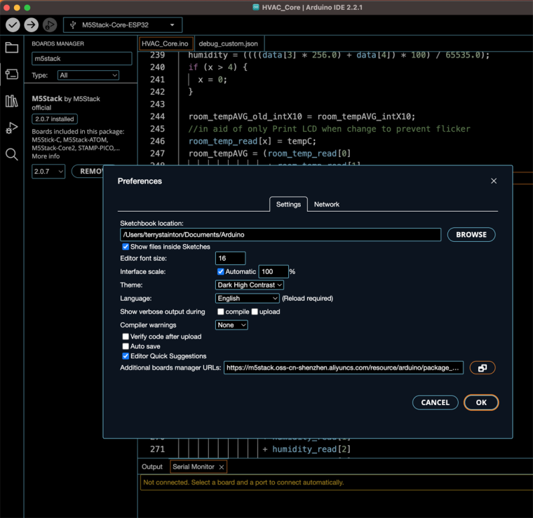

This is tricky...you may have a directory in your computer called:<br />
/Users/yourname/Library/Arduino15/packages/m5stack/hardware<br />
This is mine on a iMac...PC probably the same.<br />
Go to the m5stack folder and investigate the next level folders, such as ESP32 and the like.<br />
You may have to burn down (delete the whole structure of files!) the m5stack folder from "/Users/yourname/Library/Arduino15/packages/"<br />
and re-install the packages by letting the Arduino IDE see that the files are missing.<br />
You should consider first deleting your json link to the board defs:<br />
<img src="/assets/uploads/files/1694749979826-arduino-prefs-resized.png" alt="0_1694749977585_Arduino prefs.png" class=" img-fluid img-markdown" /><br />
To be sure that you have burnt the stack back down to<br />
"/Users/yourname/Library/Arduino15/packages/" and delete all files and folders from, and including:" m5stack &gt; hardware &gt; esp32&gt;2.0.7" and any extraneous folders beyond m5stack. (Whew!)<br />
Hopefully the Arduino IDE board defs and libraries update function will restore all the dependancies, without any conflicts.<br />
M5Stack over on the AtomS3 GitHub repository advised me to do this and it worked(!) for a problem with my new AtomS3.<br />
-Terry</p>
