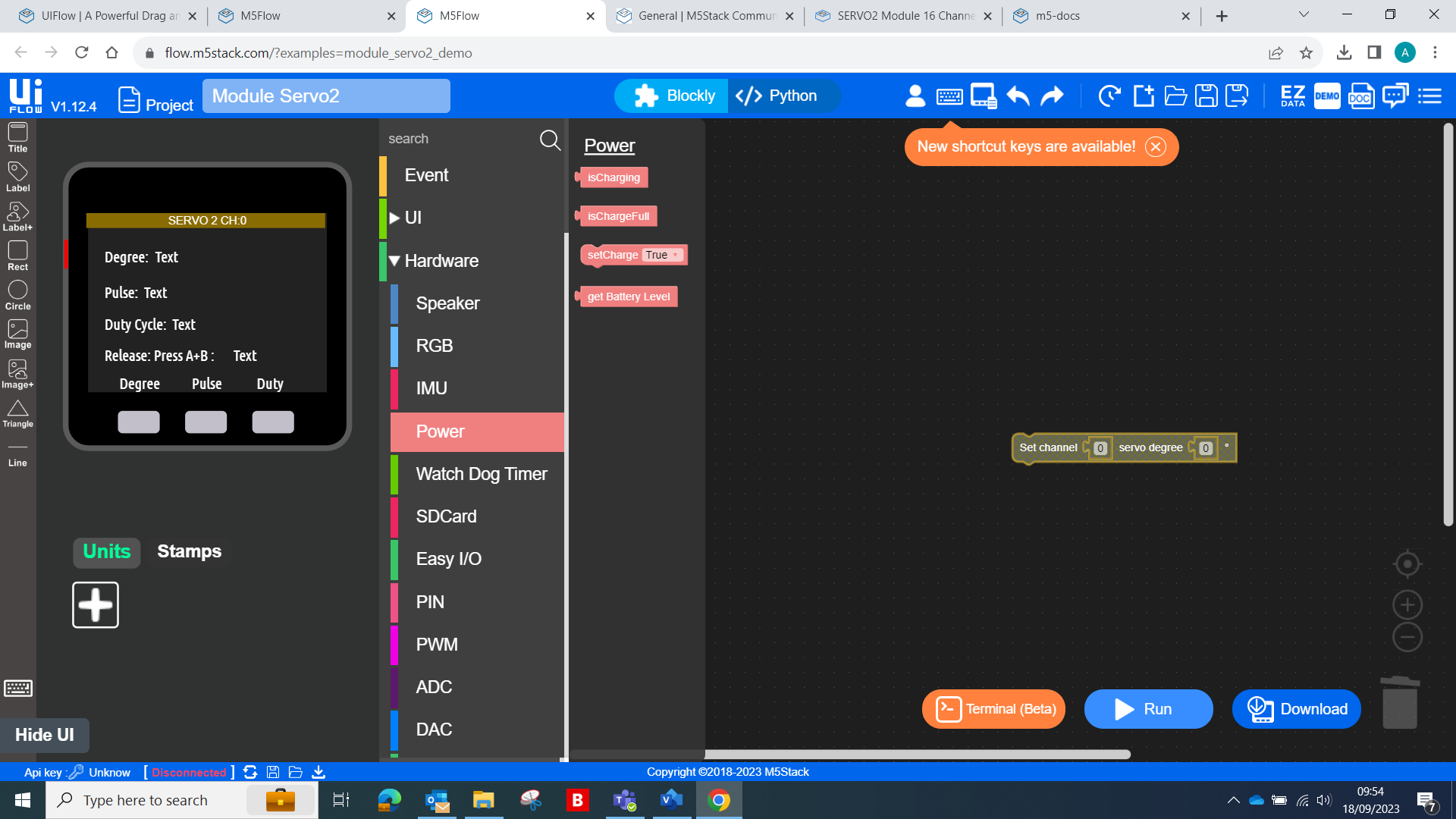

<p dir="auto">So my first project is using the servo2 module ( a bit overkill for one servo but hey ho) and the instruction in the documentation is - M-BUS power mode needs to be configured as input when the program is initialized</p>
<p dir="auto">I have searched the forum for how to carry this out in UIFlow and found the following statement - <em>UIFlow you can use the Set bus power mode disable/enable M-Bus 5V out put block. It's under Hardware - Power,  when M5Core2 is selected as device.</em> Unfortunately my version of UIFlow (V1.12.4) doesnt appear to give me that option??<br />
'''<img src="/assets/uploads/files/1695027307871-09d7a3c1-f1dd-4855-9cd6-a61c667578f7-image-resized.png" alt="0_1695027305260_09d7a3c1-f1dd-4855-9cd6-a61c667578f7-image.png" class=" img-fluid img-markdown" /><br />
Could anybody advise what I am doing wrong and what it is I should be doing please.</p>

Hi Gavin</p>
<p dir="auto">Sorry I am using the Core 2. The screenshot was taken on my work PC and that’s tied up with security so can’t connect the core2 to it. I’m guessing by what your hinting at my screen shot was not of the options available for the core 2 (my bad). When I get a chance I’ll hook it up to my home PC and see what options I get.</p>

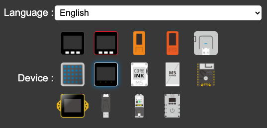

<p dir="auto"><img src="/assets/uploads/files/1695049995655-screenshot-2023-09-18-at-16.12.16.png" alt="0_1695049992716_Screenshot 2023-09-18 at 16.12.16.png" class=" img-fluid img-markdown" /><br />
Core2 is 2 along 2 down (click your API bottom left to select), which would look like the image below in the UIFlow navigation.</p>
