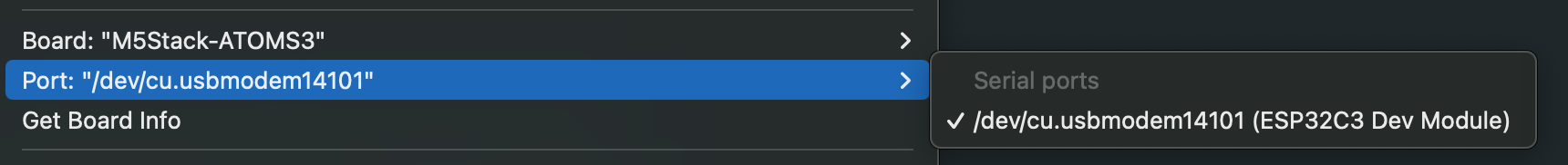

<p dir="auto">another problem if in the arduino ide i select atoms3 when i connect the board it appears as a esp32c3 and sometimes even other random chips what's going on here?<br />
<img src="/assets/uploads/files/1695313309013-newt-resized.png" alt="0_1695313306154_newt.png" class=" img-fluid img-markdown" /></p>
