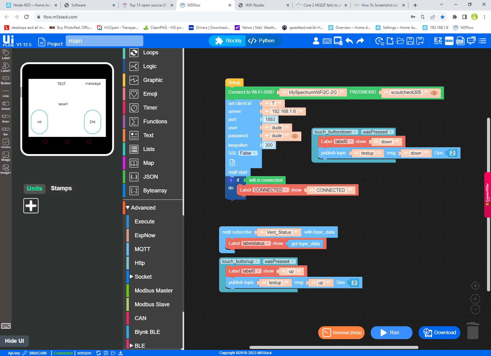

]]></description><link>https://community.m5stack.com/post/22372</link><guid isPermaLink="true">https://community.m5stack.com/post/22372</guid><dc:creator><![CDATA[ajb2k3]]></dc:creator><pubDate>Sat, 30 Sep 2023 05:41:07 GMT</pubDate></item><item><title><![CDATA[Reply to Mqtt will not publish. on Sat, 30 Sep 2023 05:39:45 GMT]]></title><description><![CDATA[<p dir="auto">@rob-driver1970 it won’t, you have published and subscribed to 2 different topics</p>
]]></description><link>https://community.m5stack.com/post/22371</link><guid isPermaLink="true">https://community.m5stack.com/post/22371</guid><dc:creator><![CDATA[ajb2k3]]></dc:creator><pubDate>Sat, 30 Sep 2023 05:39:45 GMT</pubDate></item><item><title><![CDATA[Reply to Mqtt will not publish. on Thu, 28 Sep 2023 21:52:41 GMT]]></title><description><![CDATA[<p dir="auto">Hi @rob-driver1970,</p>

]]></description><link>https://community.m5stack.com/post/22362</link><guid isPermaLink="true">https://community.m5stack.com/post/22362</guid><dc:creator><![CDATA[gavin67890]]></dc:creator><pubDate>Thu, 28 Sep 2023 21:52:41 GMT</pubDate></item><item><title><![CDATA[Reply to Mqtt will not publish. on Thu, 28 Sep 2023 21:36:48 GMT]]></title><description><![CDATA[<p dir="auto"><img src="/assets/uploads/files/1695936831690-2e4deaa1-efe9-4d68-a638-ec6d608b85e7-image-resized.png" alt="0_1695936829008_2e4deaa1-efe9-4d68-a638-ec6d608b85e7-image.png" class=" img-fluid img-markdown" /></p>
<p dir="auto">Just a test setup at the moment. I can subscribe and get the topic message. When I press the buttons, the test display shows the buttons were pressed but the message does not post to the broker.</p>
]]></description><link>https://community.m5stack.com/post/22361</link><guid isPermaLink="true">https://community.m5stack.com/post/22361</guid><dc:creator><![CDATA[rob.driver1970]]></dc:creator><pubDate>Thu, 28 Sep 2023 21:36:48 GMT</pubDate></item><item><title><![CDATA[Reply to Mqtt will not publish. on Thu, 28 Sep 2023 10:17:12 GMT]]></title><description><![CDATA[<p dir="auto">We need to see code in order to help.<br />
