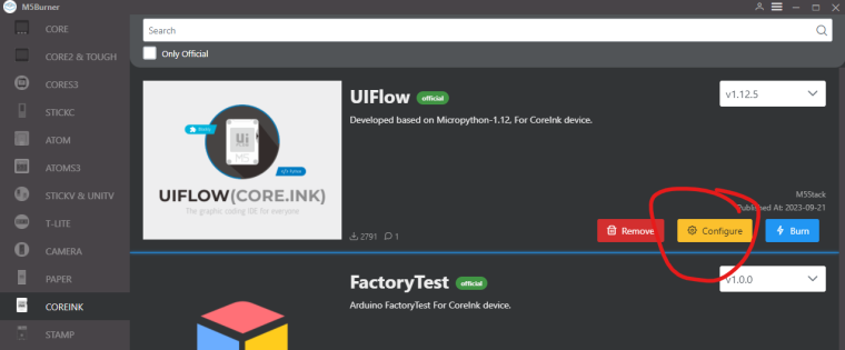

<p dir="auto"><img src="/assets/uploads/files/1696665842454-531f32c7-fba9-4564-9d17-abf343c98703-image-resized.png" alt="0_1696665834540_531f32c7-fba9-4564-9d17-abf343c98703-image.png" class=" img-fluid img-markdown" /></p>
<p dir="auto">while your device is connected with USB to your PC click configure (see picture above) and then choose the COM-port where the device is connected.</p>
