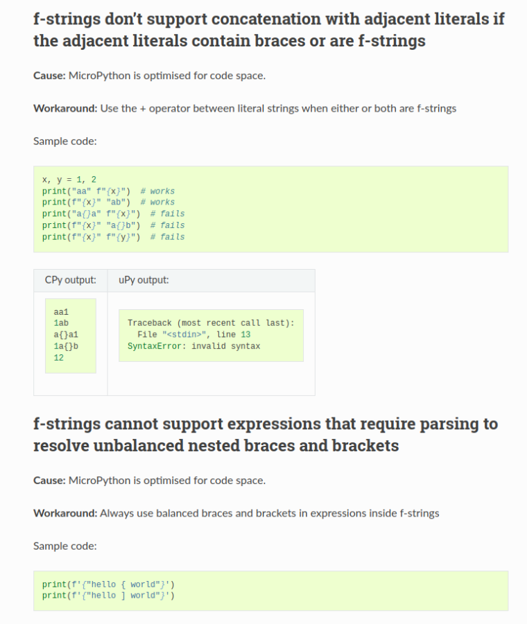

If you refer to the page you mention you can use FString but not in all scenarios.</p>
<p dir="auto">Example;:</p>
<p dir="auto">print(f"{x}" "ab")  # works<br />
print("a{}a" f"{x}")  # fails</p>
<p dir="auto">FString is therefore ‘partially’ supported in micropython</p>
<p dir="auto">Thanks anyway, now I have an official explanation ;;)</p>
]]></description><link>https://community.m5stack.com/post/22514</link><guid isPermaLink="true">https://community.m5stack.com/post/22514</guid><dc:creator><![CDATA[erich]]></dc:creator><pubDate>Fri, 20 Oct 2023 06:45:33 GMT</pubDate></item><item><title><![CDATA[Reply to String literal (f-string) not supported in uiflow &#x2F; micropython on M5StickC Plus? on Fri, 20 Oct 2023 06:15:05 GMT]]></title><description><![CDATA[<p dir="auto">Hi <a class="plugin-mentions-user plugin-mentions-a" href="/user/erich" aria-label="Profile: erich">@<bdi>erich</bdi></a> f-strings don’t support for micropython<br />
refer this link: <a href="https://docs.micropython.org/en/latest/genrst/core_language.html" target="_blank" rel="noopener noreferrer nofollow ugc">https://docs.micropython.org/en/latest/genrst/core_language.html</a></p>
<p dir="auto"><img src="/assets/uploads/files/1697782420618-wechat-screenshot_20231020141318-resized.png" alt="0_1697782420373_WeChat Screenshot_20231020141318.png" class=" img-fluid img-markdown" /></p>
