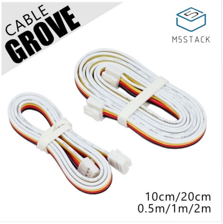

<?xml version="1.0" encoding="UTF-8"?><rss xmlns:dc="http://purl.org/dc/elements/1.1/" xmlns:content="http://purl.org/rss/1.0/modules/content/" xmlns:atom="http://www.w3.org/2005/Atom" version="2.0"><channel><title><![CDATA[[Solved]Official Grove cables - buckled or unbuckled?]]></title><description><![CDATA[<p dir="auto">Are the Grove cables on the m5stack Aliexpress store actually unbuckled cables instead of buckled?</p>
<p dir="auto"><a href="https://www.aliexpress.com/item/M5Stack-Official-Universal-4Pin-Buckled-Grove-Cable-1m-2m-50cm-20cm-10cm/32949298454.html?spm=a2g0s.9042311.0.0.47c74c4dahwq66" target="_blank" rel="noopener noreferrer nofollow ugc">https://www.aliexpress.com/item/M5Stack-Official-Universal-4Pin-Buckled-Grove-Cable-1m-2m-50cm-20cm-10cm/32949298454.html?spm=a2g0s.9042311.0.0.47c74c4dahwq66</a></p>
<p dir="auto"><img src="/assets/uploads/files/1549028029281-screen-shot-2019-02-01-at-8.33.12-am-resized.png" alt="0_1549028014052_Screen Shot 2019-02-01 at 8.33.12 AM.png" class=" img-fluid img-markdown" /></p>
<p dir="auto">As you can see from the description and picture, they show a buckled cable.  So I ordered buckled Grove cables from a vendor on Amazon Prime so I could get them in 2 days while I wait for my shipment from China for the official m5stack Grove cables (19-39 day delivery).  Upon arrival from Amazon, I found the cables do not fit the m5stack core because of the buckle.  Can someone post a picture of their official m5stack grove cable?</p>

]]></description><link>https://community.m5stack.com/post/3981</link><guid isPermaLink="true">https://community.m5stack.com/post/3981</guid><dc:creator><![CDATA[ministryman]]></dc:creator><pubDate>Wed, 24 Apr 2019 18:56:07 GMT</pubDate></item><item><title><![CDATA[Reply to [Solved]Official Grove cables - buckled or unbuckled? on Tue, 05 Feb 2019 01:21:09 GMT]]></title><description><![CDATA[<p dir="auto">Thanks guys. Looks like I will just cut the buckle off when I need to.</p>
]]></description><link>https://community.m5stack.com/post/2866</link><guid isPermaLink="true">https://community.m5stack.com/post/2866</guid><dc:creator><![CDATA[world101]]></dc:creator><pubDate>Tue, 05 Feb 2019 01:21:09 GMT</pubDate></item><item><title><![CDATA[Reply to [Solved]Official Grove cables - buckled or unbuckled? on Sun, 03 Feb 2019 06:22:48 GMT]]></title><description><![CDATA[<p dir="auto">As far as I know they all come buckled with the extra piece on top from the factory, we just remove that part  then they fit into the grove port fine, a pair of scissors or a knife should do the trick.</p>
]]></description><link>https://community.m5stack.com/post/2826</link><guid isPermaLink="true">https://community.m5stack.com/post/2826</guid><dc:creator><![CDATA[lukasmaximus]]></dc:creator><pubDate>Sun, 03 Feb 2019 06:22:48 GMT</pubDate></item><item><title><![CDATA[Reply to [Solved]Official Grove cables - buckled or unbuckled? on Sat, 02 Feb 2019 12:47:35 GMT]]></title><description><![CDATA[<p dir="auto">This is correct as the buckle fits securely to the stick/camera and units.<br />
I have chopped the clip of some but also ordered Seeedstudio grove leads that don't have the buckle.</p>
]]></description><link>https://community.m5stack.com/post/2816</link><guid isPermaLink="true">https://community.m5stack.com/post/2816</guid><dc:creator><![CDATA[ajb2k3]]></dc:creator><pubDate>Sat, 02 Feb 2019 12:47:35 GMT</pubDate></item></channel></rss>
