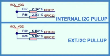

<p dir="auto">I will try on 3.3V, 5.1k seems good instead of 4.7k, but I use DS18B20 on long range (50m) and I am afraid 3.3V is not enough.</p>
<p dir="auto">what happens if I connect 5V? do I risk destroying GPIO33 or the whole board?<br />
I have to tell that after many tests over long periods of time, I've never burned out a GPIO using an external 4.7k resistor on the 5V, but may be it is possible while using internal pullup.</p>
<p dir="auto">I can see that GPIO21/22 are 2.2k, may be it is better to have more current for long distance ?</p>
<p dir="auto"><img src="/assets/uploads/files/1697229905728-54757a4c-1d76-4971-9bf7-899bd111cb2e-image.png" alt="0_1697229904447_54757a4c-1d76-4971-9bf7-899bd111cb2e-image.png" class=" img-fluid img-markdown" /></p>

<p dir="auto">check out the M5Core2 <a href="https://docs.m5stack.com/en/core/core2" target="_blank" rel="noopener noreferrer nofollow ugc">schematic</a>. Port A is using GPIO32 / 33 and yes, there are internal pull-up resistors (5.1 k) to MCU_VDD (= 3.3 V).</p>
<p dir="auto">According to the DS18B20 <a href="https://www.analog.com/media/en/technical-documentation/data-sheets/ds18b20.pdf" target="_blank" rel="noopener noreferrer nofollow ugc">datasheet</a> minimal voltage is 3.0 V, so it should work being powered with 3.3 V.</p>
<p dir="auto">Note: ESP32 GPIOs are not 5 V tolerant, so I would not use an external pull-up to 5 V.</p>
