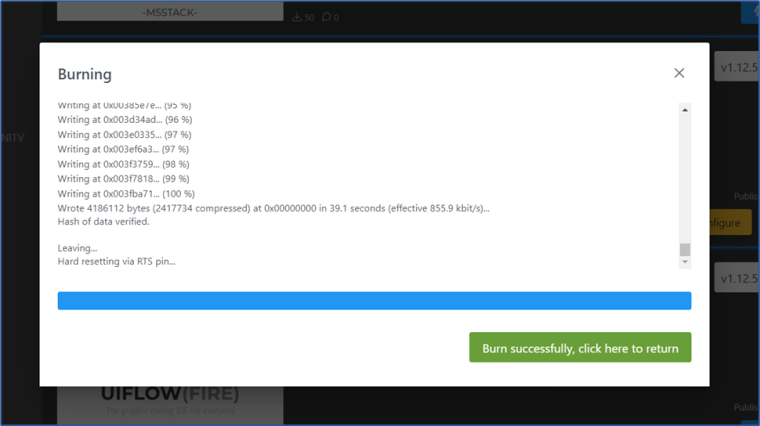

<p dir="auto">We attempted to connect the M5Stack Core2 ESP32 IoT Development Kit to the computer using a Type-C data cable and successfully completed the burn process. However, the device screen is not functioning.</p>

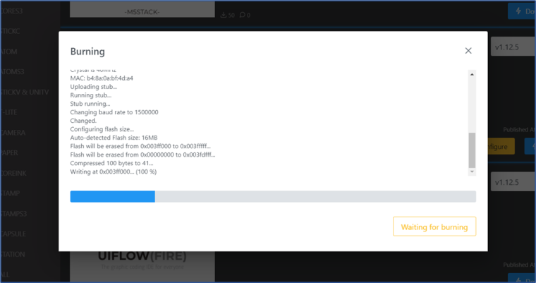

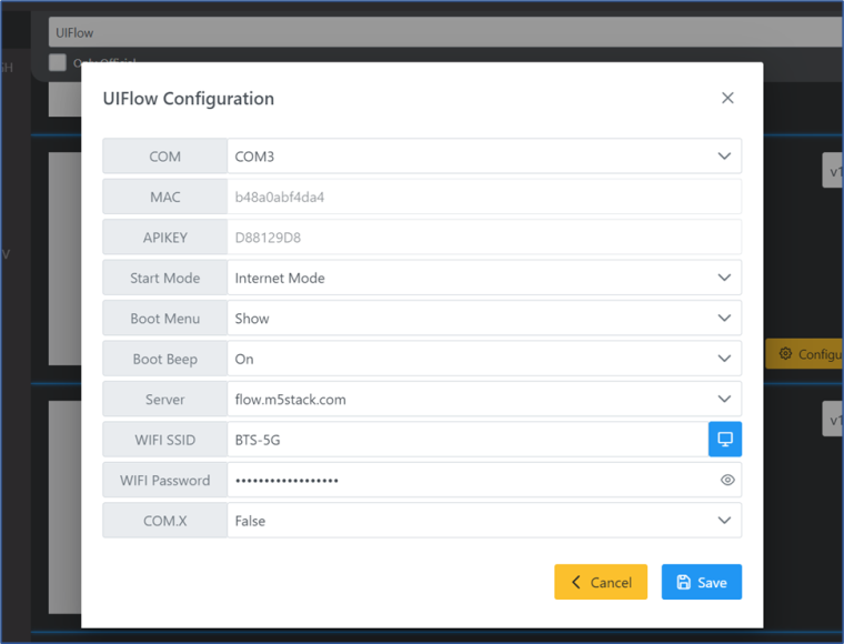

<p dir="auto">After this step:<br />
The M5Stack Core2 ESP32 IoT Development Kit was not connected to the UI Flow.<br />
After some time, it became unresponsive. The screen did not turn on, and there was a ticking sound.<br />
It appears that erasing the flash leaves the device in a non-functional state on the next boot-up.</p>
<p dir="auto">Find the attached images for more information and steps that I did.</p>
