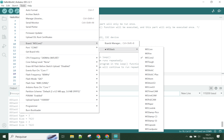

I'm trying several codes, including the native sample code "Hello World":</p>
<p dir="auto">#include &lt;M5Core2.h&gt;<br />
void setup(){<br />
M5.begin(); //Init M5Core2. Initialize M5Core2<br />
/* Power chip connected to gpio21, gpio22, I2C device<br />
Set battery charging voltage and current<br />
If used battery, please call this function in your project */<br />
M5.Lcd.print("Hello World"); // Print text on the screen (string) Print text on the screen (string)<br />
}</p>
<p dir="auto">/* After the program in setup() runs, it runs the program in loop()<br />
The loop() function is an infinite loop in which the program runs repeatedly<br />
After the program in the setup() function is executed, the program in the loop() function will be executed<br />
The loop() function is an endless loop, in which the program will continue to run repeatedly */<br />
void loop() {<br />
Serial.println("Teste");<br />
}</p>
<p dir="auto">See my environment configuration:<br />
<img src="/assets/uploads/files/1697754389944-79207256-421f-44ee-bd91-ce341de9dc0e-arduino-resized.png" alt="0_1697754384317_79207256-421f-44ee-bd91-ce341de9dc0e-Arduino.png" class=" img-fluid img-markdown" /></p>
<p dir="auto">The data in the serial monitor comes from my Core2 when running the factory code.<br />
The only thing I haven't tried yet is to record my device from a different computer.<br />
I'll try to do that.</p>

<p dir="auto">hmm, not sure what's going on here.</p>
<p dir="auto">Are you sure you are using the M5Core2 <a href="https://github.com/m5stack/M5Core2" target="_blank" rel="noopener noreferrer nofollow ugc">library</a> and have selected the correct board in Arduino IDE?</p>
<p dir="auto">Can you share the code you are trying to run?</p>
<p dir="auto">BTW: the green LED is controlled by the AXP192; so if it is not initialized correctly the green LED will not be on.</p>
<p dir="auto">Thanks<br />
Felix</p>
