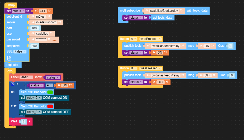

<?xml version="1.0" encoding="UTF-8"?><rss xmlns:dc="http://purl.org/dc/elements/1.1/" xmlns:content="http://purl.org/rss/1.0/modules/content/" xmlns:atom="http://www.w3.org/2005/Atom" version="2.0"><channel><title><![CDATA[MQTT Issues]]></title><description><![CDATA[<p dir="auto">I'm attempting to control a relay via MQTT.  I've tried both <a href="http://io.adafruit.com" target="_blank" rel="noopener noreferrer nofollow ugc">io.adafruit.com</a> and <a href="http://cloudmqtt.com" target="_blank" rel="noopener noreferrer nofollow ugc">cloudmqtt.com</a>.  Using MQTTool on my phone, I'm able to connect/subscribe/publish to both services utilizing the same information as shown in the blocks.</p>
<p dir="auto">Are there any glaring issues with my code blocks here?  I've attempted this many different ways and I believe that this should work, but it doesn't appear that the M5Stack is connecting to either service.  I've upgraded to firmware V1.12.6 and I'm working with UiFlow1.</p>
<p dir="auto"><img src="/assets/uploads/files/1698431376309-adafruit-resized.png" alt="0_1698431375562_adafruit.PNG" class=" img-fluid img-markdown" /></p>
<p dir="auto">Is there anyone out there who has been successful with this?  It looks like there have been firmware issues in the past - is there a firmware version that is stable with MQTT?</p>
