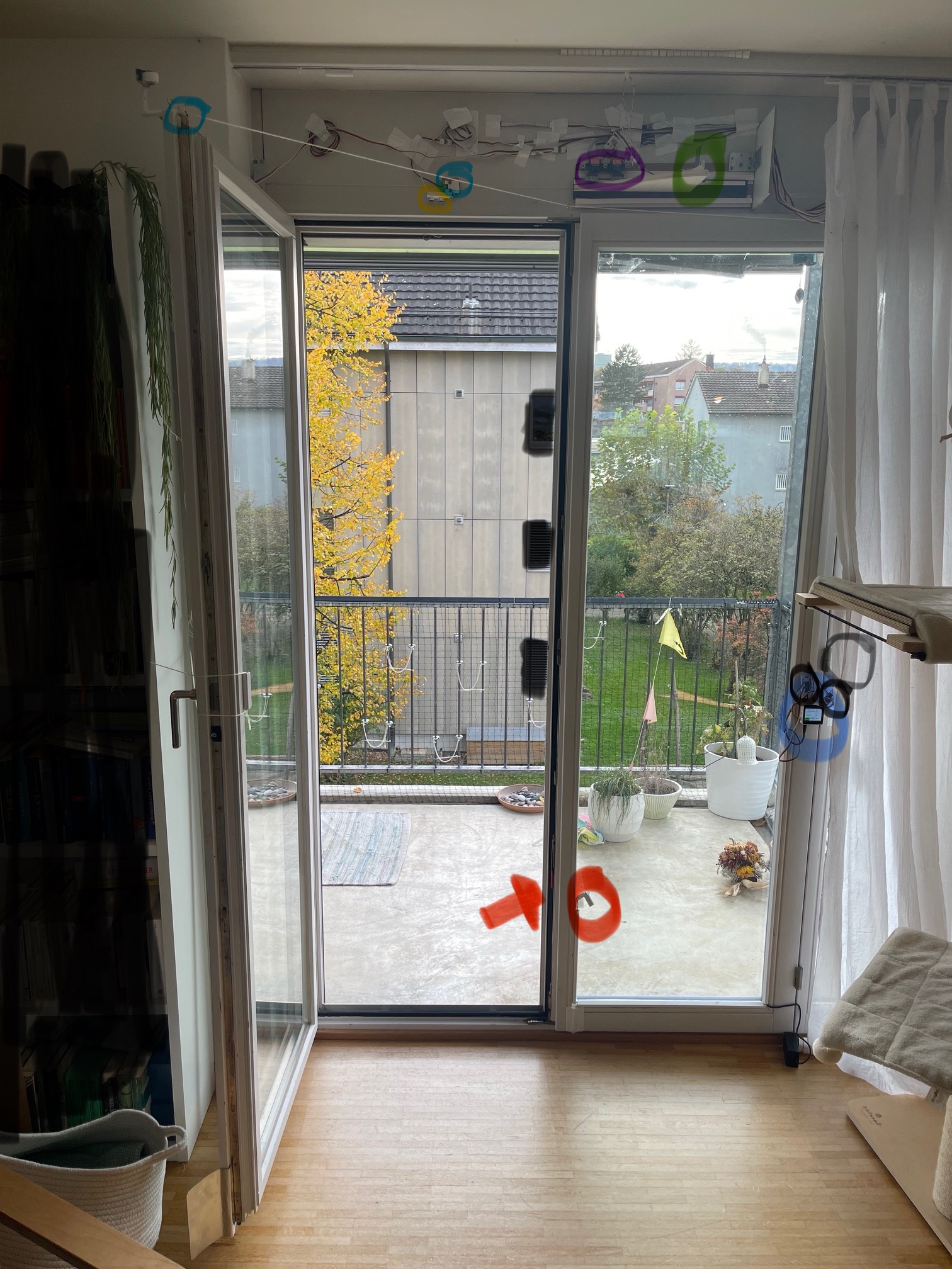

<p dir="auto">I was looking for automatic cat door, but with a real door. Then I saw the M5Stack Shop and decided to try it by myself…</p>
<p dir="auto">Thats the result from my first project with M5-Stuff and UiFlow! Not yet looking good. But first it has to work for a few days before I fix all the cables.</p>
<p dir="auto">The door opens only about 15cm! Not like the picture. And stays open for 15 seconds. With a led stripe as a  countdown/up</p>

<p dir="auto">Material:<br />
Core2 with DinBase and a 12V power adapter<br />
1 PaHub ( next to the Core)<br />
1 PbHub ( next to the Core)<br />
2 Pir Units ( 1 inside and 1 outside with a pipe around for smaller angles)<br />
2 Limit Units (1 on the open door and 1 above left)<br />
1 TOF Unit (1 on the sliding triangle)<br />
1 DayLight Unit (behind the robe for the brightness)<br />
1 Ultra Sonic ( upper left)<br />
2 x 360° servos<br />
1 Groove Hub<br />
1 Led Stripe (just for fun)<br />
1SD Card for Door-Status-Logfiles<br />
Some lego bricks and gears<br />
And a lot of cables</p>
<p dir="auto">And of corse some home working materials</p>
<p dir="auto">We got 2 chipped cats. The already ordered Rfid Units works at 13 Hz not at 134.2 for the cats. So I cant „read“ which cat is inside. They leave on the right. I planned to make a tunnel with 1 unit at the entrance and 1 at the exit. With the ID and the timestamp I can see hows in or out. If someone knows how to realize that, please tell me!</p>
