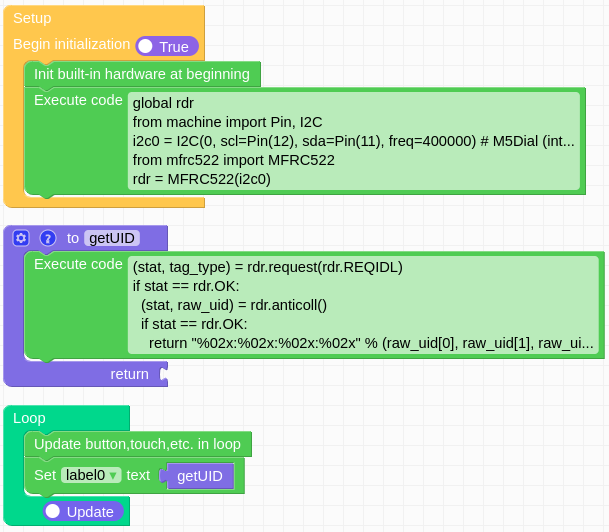

]]></description><link>https://community.m5stack.com/post/23238</link><guid isPermaLink="true">https://community.m5stack.com/post/23238</guid><dc:creator><![CDATA[felmue]]></dc:creator><pubDate>Fri, 05 Jan 2024 15:23:56 GMT</pubDate></item><item><title><![CDATA[Reply to M5Dial mising nfc machine module... on Sat, 25 Nov 2023 09:44:43 GMT]]></title><description><![CDATA[<p dir="auto">Hello <a class="plugin-mentions-user plugin-mentions-a" href="/user/jamesarm97" aria-label="Profile: jamesarm97">@<bdi>jamesarm97</bdi></a></p>
<p dir="auto">please check out the example code below to get the card UID into an UIFlow2 label.</p>
<p dir="auto">Notes:</p>
<ul>
<li>you need to create a label first</li>
<li>observe the <code>global rdr</code> statement at the top of the first <code>Execute code</code> block. It is required to make the function <code>getUID</code> work</li>
<li>observe the function <code>getUID</code> is of the type with return parameter, although it is not set. The return value is set by the <code>return</code> statement in the <code>Execute code</code> block.</li>
</ul>
<p dir="auto"><img src="/assets/uploads/files/1700904709852-uiflow2_m5dial_rfid_20231125.png" alt="0_1700904706191_UIFlow2_M5Dial_RFID_20231125.png" class=" img-fluid img-markdown" /></p>
<p dir="auto">Please find the complete example <a href="https://github.com/felmue/micropython-mfrc522/blob/fm-micropyton-mfrc522-i2c/examples/UIFlow2_M5Dial_RFID_20231125.m5f2" target="_blank" rel="noopener noreferrer nofollow ugc">here</a>.</p>
<p dir="auto">Thanks<br />
Felix</p>

]]></description><link>https://community.m5stack.com/post/22889</link><guid isPermaLink="true">https://community.m5stack.com/post/22889</guid><dc:creator><![CDATA[jamesarm97]]></dc:creator><pubDate>Fri, 24 Nov 2023 22:27:07 GMT</pubDate></item><item><title><![CDATA[Reply to M5Dial mising nfc machine module... on Sat, 25 Nov 2023 09:22:32 GMT]]></title><description><![CDATA[<p dir="auto">Hello guys</p>
<p dir="auto">I found an existing MFRC522 library which I modified so it can be used with UIFlow2 and M5Dial.</p>
<p dir="auto">The <code>mrfc522.py</code> library <a href="https://github.com/felmue/micropython-mfrc522/blob/fm-micropyton-mfrc522-i2c/mfrc522.py" target="_blank" rel="noopener noreferrer nofollow ugc">file</a> can be downloaded into M5Dial using Chrome, UIFlow2 and its <code>Device File Manager</code>. Place it alongside the already existing <code>boot.py</code> and <code>main.py</code>.</p>
<p dir="auto">After that you can use an <code>Execute code</code> block to run an <a href="https://github.com/felmue/micropython-mfrc522/tree/fm-micropyton-mfrc522-i2c/examples" target="_blank" rel="noopener noreferrer nofollow ugc">example</a> to read the version, scan, read or write a card.</p>
<p dir="auto">Note : tested with UIFlow2.0.0 Alpha-28 firmware.</p>
Felix</p>
