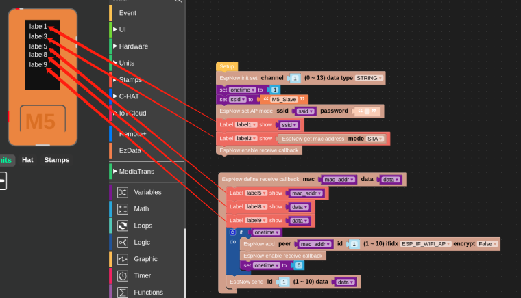

Because all examples are designed for "core-basic" (device name), not stickc or other core devices (core2, fire, etc...), So you first understand the example logic and create (stickc) ui blocks that are relevant to your device.</p>
<p dir="auto">Like this:<br />
<img src="/assets/uploads/files/1701308318378-d039786c-0e9a-4d19-a3b6-4614557fcc28-efaaf7dd78ac7e23b62602f8b91dfe8-resized.png" alt="0_1701308318070_d039786c-0e9a-4d19-a3b6-4614557fcc28-efaaf7dd78ac7e23b62602f8b91dfe8.png" class=" img-fluid img-markdown" /></p>
