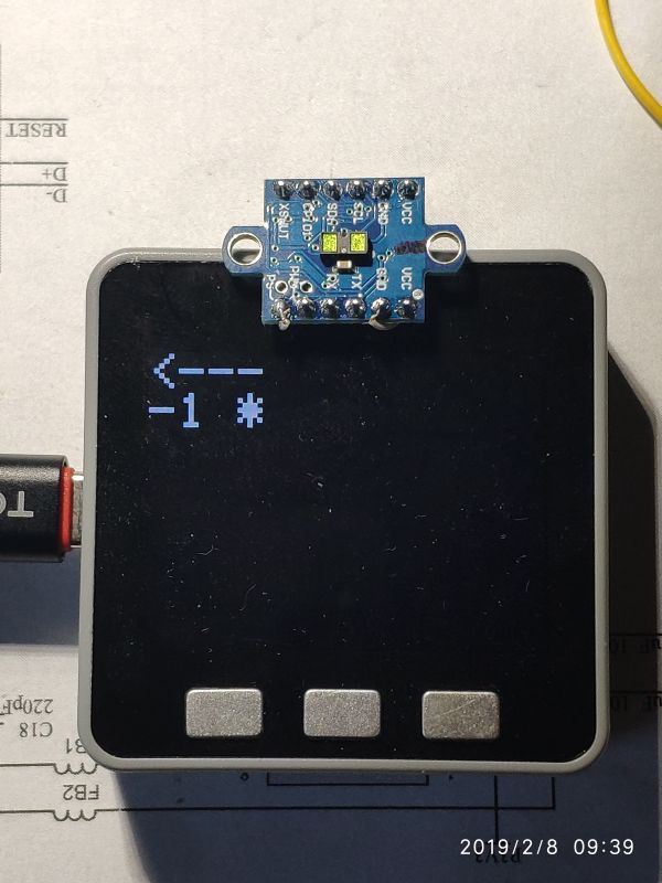

<p dir="auto">This example illustrates direction recognition with the single VL53L1X TOF sensor. Two Regions Of Interest(ROI) are defined in SPAD sensor array:<br />

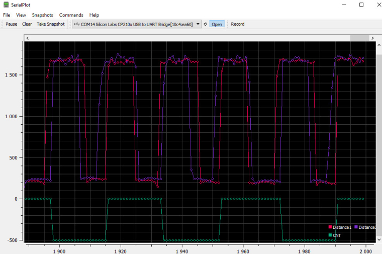

Data measurements distance0 and distance1 cyclically readed from both ROIs, switching them on the fly.<br />
Then STM32duino_Proximity_Gesture library used for event interpretation.<br />
To suit Arduino requirement I added necessary library description to <strong>Pololu vl53l1_ap</strong>i.<br />
Also, to handle <strong>handMustCoverBoth</strong> parameter support in STM32duino_Proximity_Gesture library, I had to slightly modify tof_gestures_DIRSWIPE_1.cpp and tof_gestures_DIRSWIPE_1.h. Both libraries are included in this bundle.</p>
<p dir="auto">Data outputs to serial @115200 and to OLED. For investigations and adjustments it is suitable to use SerialPlot: <a href="https://bitbucket.org/hyOzd/serialplot" target="_blank" rel="noopener noreferrer nofollow ugc">https://bitbucket.org/hyOzd/serialplot</a>.<br />

You should use exactly the libraries attached to project, as they were patched to suit classic gesture lib requirements and  due to limited functionality of ESP32 Wire library. Also due this terrible Wire lib M5STACK works slower (42 Hz sample rate than to say ESP8266(72 Hz)).<br />
