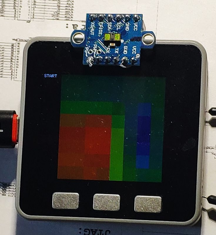

<?xml version="1.0" encoding="UTF-8"?><rss xmlns:dc="http://purl.org/dc/elements/1.1/" xmlns:content="http://purl.org/rss/1.0/modules/content/" xmlns:atom="http://www.w3.org/2005/Atom" version="2.0"><channel><title><![CDATA[Distance Visualization With Multiple SPAD areas in VL53L1X Time-of-Flight sensor]]></title><description><![CDATA[<p dir="auto">This example illustrates how to get information from multiple SPAD areas from VL53L1X TOF sensor. 16 Regions Of Interest(ROI) with size of 4 * 4 SPAD elements each are defined in SPAD sensor array. Thus, a 4 * 4 measurement matrix formed. Distances measured from each of 16 ROI, interpolated to 8 * 8 image and displayed as Thermal like image.<br />
Code here:<br />
<a href="https://yadi.sk/d/qpxO0fMItW4Qpw" target="_blank" rel="noopener noreferrer nofollow ugc">https://yadi.sk/d/qpxO0fMItW4Qpw</a><br />
Video here:<br />
<a href="https://youtu.be/b18ghRCWawo" target="_blank" rel="noopener noreferrer nofollow ugc">https://youtu.be/b18ghRCWawo</a></p>
<p dir="auto"><img src="/assets/uploads/files/1549627641835-distance.jpg" alt="0_1549627639513_Distance.jpg" class=" img-fluid img-markdown" /></p>
