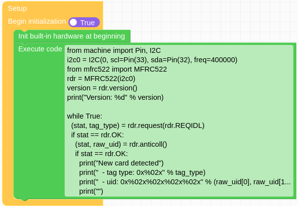

<p dir="auto">as of UIFlow<strong>2</strong> alpha-28 the RFID/RFID2 unit is not (yet) supported.</p>
<p dir="auto">That said, I see three options for you:</p>
<ul>
<li>wait until RFID/RFID2 is officially supported in UIFlow<strong>2</strong></li>
<li>use UIFlow<strong>1</strong> instead which has support for RFID/RFID2 unit</li>
<li>in UIFlow<strong>2</strong> download this <a href="https://github.com/felmue/micropython-mfrc522/blob/fm-micropyton-mfrc522-i2c/mfrc522.py" target="_blank" rel="noopener noreferrer nofollow ugc">library</a> onto your M5StickCPlus and then use below code:</li>
</ul>
<p dir="auto"><img src="/assets/uploads/files/1703451065046-ui2_m5stickcplus_rfid_20231224.png" alt="0_1703451066495_UI2_M5StickCPlus_RFID_20231224.png" class=" img-fluid img-markdown" /></p>
<p dir="auto">Thanks<br />
Felix</p>
