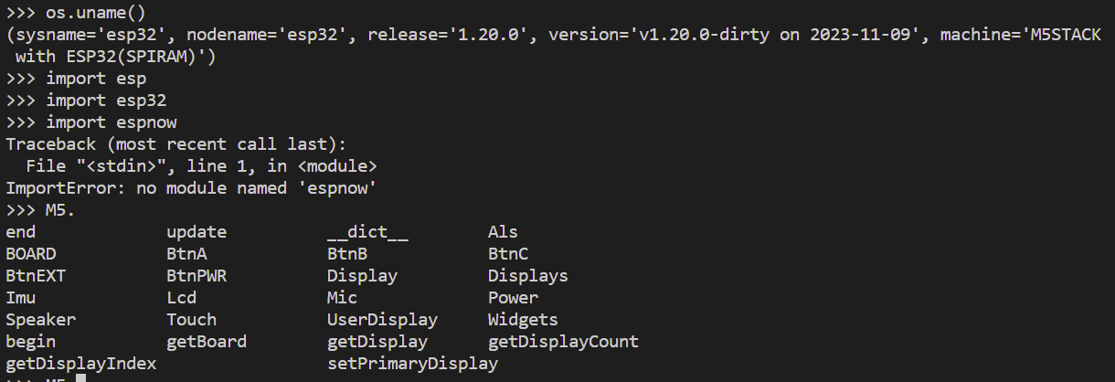

<?xml version="1.0" encoding="UTF-8"?><rss xmlns:dc="http://purl.org/dc/elements/1.1/" xmlns:content="http://purl.org/rss/1.0/modules/content/" xmlns:atom="http://www.w3.org/2005/Atom" version="2.0"><channel><title><![CDATA[ESPNow in UIFlow&#x2F;MicroPython on M5StickC Plus2?]]></title><description><![CDATA[<p dir="auto">The M5StickC Plus2 Firmware doesn't seem to have ESPNow support. Is this expected to be added at a later date, or is support for ESPNow being discontinued?</p>
<p dir="auto"><img src="/assets/uploads/files/1703780107139-5821beea-4756-4d96-b74a-601301c86ac0-image-resized.png" alt="0_1703780106244_5821beea-4756-4d96-b74a-601301c86ac0-image.png" class=" img-fluid img-markdown" /></p>
]]></description><link>https://community.m5stack.com/topic/5922/espnow-in-uiflow-micropython-on-m5stickc-plus2</link><generator>RSS for Node</generator><lastBuildDate>Wed, 29 Apr 2026 02:29:59 GMT</lastBuildDate><atom:link href="https://community.m5stack.com/topic/5922.rss" rel="self" type="application/rss+xml"/><pubDate>Thu, 28 Dec 2023 16:15:15 GMT</pubDate><ttl>60</ttl><item><title><![CDATA[Reply to ESPNow in UIFlow&#x2F;MicroPython on M5StickC Plus2? on Wed, 03 Jan 2024 06:04:08 GMT]]></title><description><![CDATA[<p dir="auto">I too am extremely interested in this. I've been trying to program some wireless stuff on a couple of M5StickC Plus2s using UIFlow and ESP-Now... The only thing is I'm not seeing any ESP-Now options in the new UIFlow 2.0. There are block options in v 1.0 but when I use those I've been running into errors.</p>

Espnow supports official MicroPython firmware above version 1.21.0, our team tries to use mpy 1.21.0 + espidf (above v5.0). Can be used as soon as possible.</p>
