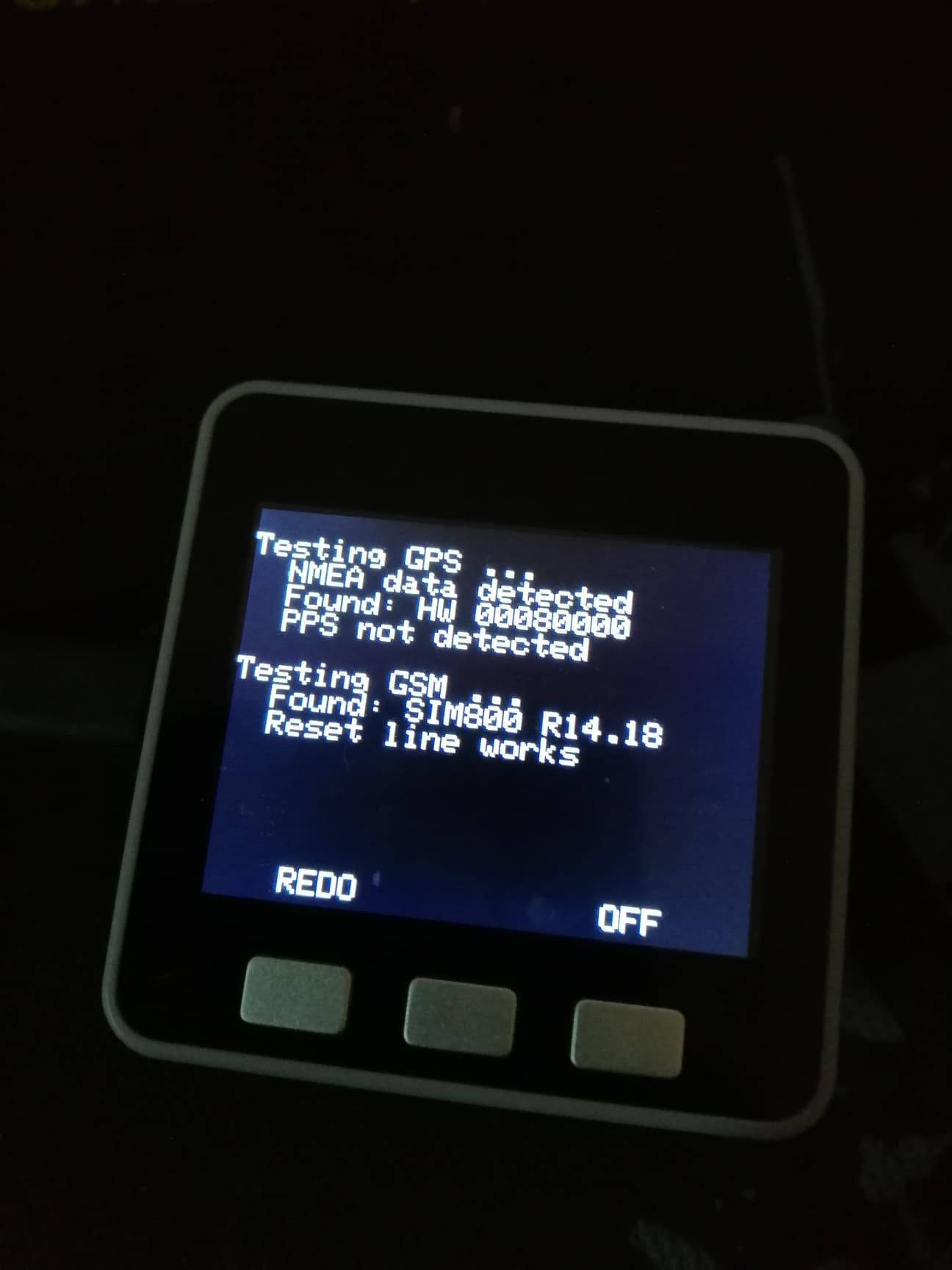

Thank you sir, knife it work.</p>

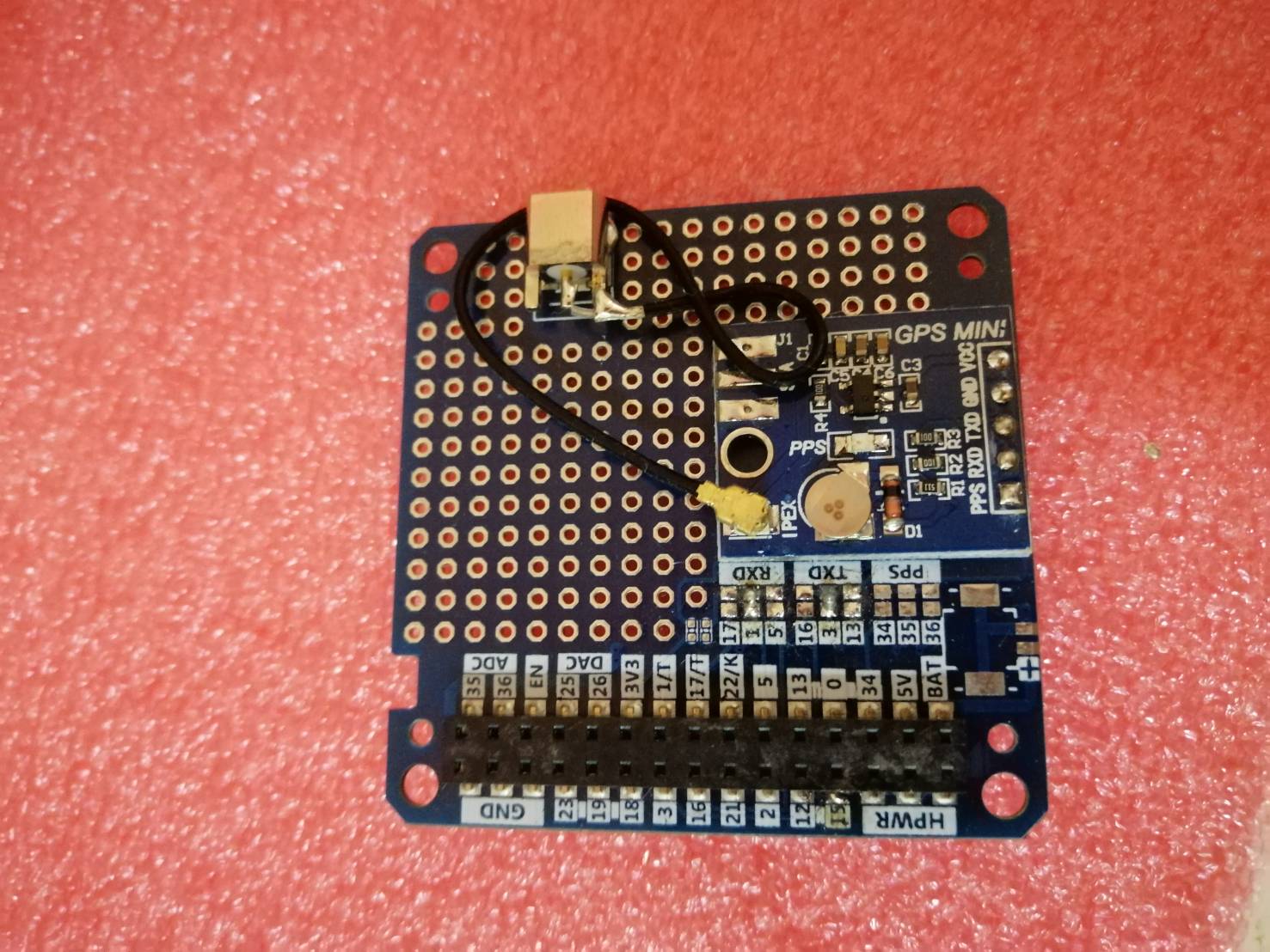

]]></description><link>https://community.m5stack.com/post/3338</link><guid isPermaLink="true">https://community.m5stack.com/post/3338</guid><dc:creator><![CDATA[m5-docs]]></dc:creator><pubDate>Mon, 18 Mar 2019 09:06:16 GMT</pubDate></item><item><title><![CDATA[Reply to How to use GPS module with SIM800L Module? on Mon, 18 Mar 2019 08:35:18 GMT]]></title><description><![CDATA[<p dir="auto"><img src="/assets/uploads/files/1552898009659-37200-resized.jpg" alt="0_1552898007881_37200.jpg" class=" img-fluid img-markdown" /></p>
<p dir="auto">I re-soldering RX-1 and TX-3. is it correct?</p>
]]></description><link>https://community.m5stack.com/post/3334</link><guid isPermaLink="true">https://community.m5stack.com/post/3334</guid><dc:creator><![CDATA[poydevelop]]></dc:creator><pubDate>Mon, 18 Mar 2019 08:35:18 GMT</pubDate></item><item><title><![CDATA[Reply to How to use GPS module with SIM800L Module? on Mon, 18 Mar 2019 07:40:41 GMT]]></title><description><![CDATA[<p dir="auto">how to cutting the existing bridge?</p>

]]></description><link>https://community.m5stack.com/post/2925</link><guid isPermaLink="true">https://community.m5stack.com/post/2925</guid><dc:creator><![CDATA[poydevelop]]></dc:creator><pubDate>Tue, 12 Feb 2019 18:03:27 GMT</pubDate></item><item><title><![CDATA[Reply to How to use GPS module with SIM800L Module? on Mon, 11 Feb 2019 22:22:50 GMT]]></title><description><![CDATA[<p dir="auto">Change the pins for the GPS module as follows (by cutting the existing bridge and re-soldering). Only downside is, that the Serial monitor/output is not available anymore</p>
<ul>
<li>RXD: 1</li>
<li>TXD: 3</li>
<li>PPS (not connected)</li>
</ul>
<p dir="auto">Now, you can use the GPS module on the serial port 0:</p>
