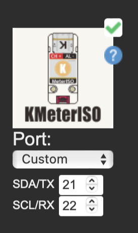

]]></description><link>https://community.m5stack.com/post/23246</link><guid isPermaLink="true">https://community.m5stack.com/post/23246</guid><dc:creator><![CDATA[ajb2k3]]></dc:creator><pubDate>Sat, 06 Jan 2024 08:56:22 GMT</pubDate></item></channel></rss>
