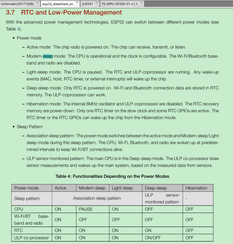

<img src="/assets/uploads/files/1604174250922-be97bcb0-73ec-4ef4-aaf0-ad7a9a5c5df7-image.png" alt="0_1604174249013_be97bcb0-73ec-4ef4-aaf0-ad7a9a5c5df7-image.png" class=" img-fluid img-markdown" /></p>
]]></description><link>https://community.m5stack.com/post/10559</link><guid isPermaLink="true">https://community.m5stack.com/post/10559</guid><dc:creator><![CDATA[AndyT]]></dc:creator><pubDate>Sat, 31 Oct 2020 19:57:36 GMT</pubDate></item><item><title><![CDATA[Reply to Display on during deep sleep? on Sat, 31 Oct 2020 09:47:36 GMT]]></title><description><![CDATA[<p dir="auto">Hello Andy</p>

<p dir="auto">Thank you.<br />
What some people dont know is that the esp32 is not like an arduino.<br />
the esp32 has 3 cores, 2 primary and 1 Ultra Low power.<br />
In true deep sleep, the primary core are deactivated and the basic "Upkeep" code is off loaded to the ULP.<br />
Because the M5Stack is based on the ESP32 and not much is understood about the ULP, very little progress has been made on deep sleep.<br />
In theory, from what I have read the ULP could maintain a low power screen for a Like (to use your example) and then wake up the core to take the sensor measurements before storing them (for the ulp to recall and display) putting the cores back to sleep.</p>
<p dir="auto">If you are interested in leaning more, look into the ESP32's ULP (Ultra Low Power core)</p>
