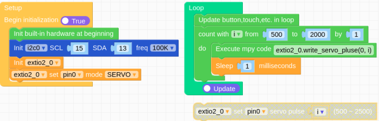

<p dir="auto">make sure the EXT.IO2 unit is connected to the <strong>red</strong> Groove port of M5Dial. I get the error you mentioned if I disconnect the unit.</p>
<p dir="auto">Below are the blocks that work for me.</p>
<p dir="auto"><img src="/assets/uploads/files/1705191084668-uiflow2_m5dial_ioext2_20240114-resized.png" alt="0_1705191083201_UIFlow2_M5Dial_IOEXT2_20240114.png" class=" img-fluid img-markdown" /></p>
<p dir="auto">Note: there is a typo in M5Dial firmware - it expects <code>write_servo_pluse()</code> instead of <code>write_servo_pulse()</code>. Therefore you cannot use the prepared block (until UIFlow firmware is fixed). Instead an <code>Execute mpy code</code> block can help out. <a href="https://github.com/m5stack/uiflow-micropython/pull/17" target="_blank" rel="noopener noreferrer nofollow ugc">PR</a> to fix typo created.</p>

<p dir="auto">ok, I see. It looks like the <code>count do</code> loop fires of the <code>i2c</code> commands too quickly. I can make it work by adding a <code>sleep 1 milliseconds</code> block after the <code>set servo pulse</code> block.</p>
<p dir="auto">Thanks<br />
Felix</p>
