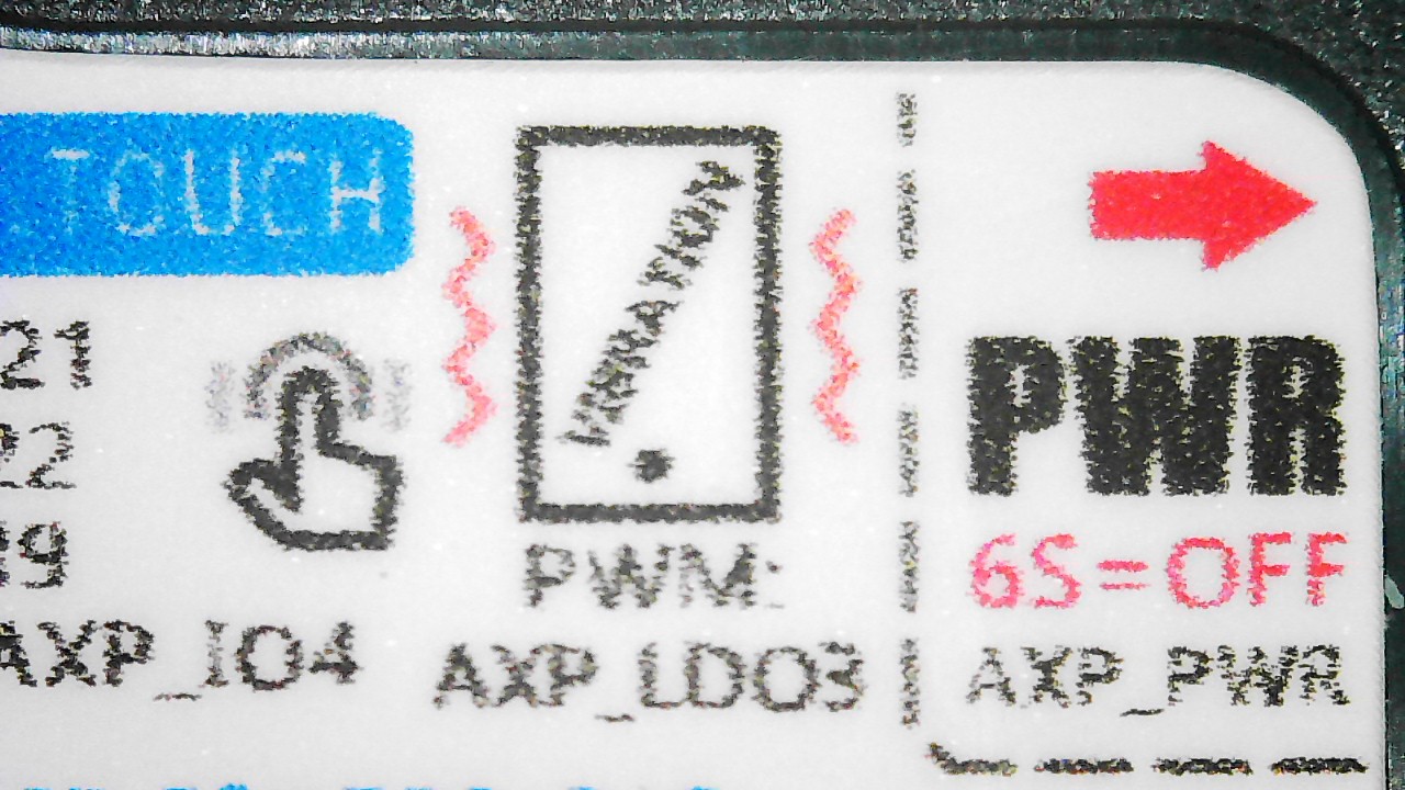

<p dir="auto">I am using Previous Core2 (K010) and New Core2 (K010-V11) .<br />
Previous Core2 Vibration can work with following code but New Core2 Vibration cannot work.<br />
Core2 bottom show Previous:AXP-LDO3 -&gt; New:DLA01.<br />
Is there any example code to work DAL01?</p>
<p dir="auto">[code]<br />
M5.Axp.SetLDOEnable(3, true);<br />
delay(100);<br />
M5.Axp.SetLDOEnable(3, false);</p>
<p dir="auto">[Previous Core2 bottom]<br />
<img src="/assets/uploads/files/1705296373463-previous-k010-resized.jpg" alt="0_1705296371924_Previous(K010).jpg" class=" img-fluid img-markdown" /></p>
<p dir="auto">[New Core2 bottom]<br />
<img src="/assets/uploads/files/1705296410634-new-k010-v11-resized.jpg" alt="0_1705296410046_New(K010-V11).jpg" class=" img-fluid img-markdown" /></p>

<p dir="auto">simply call <code>M5.Axp.SetVibration(true/false)</code> - this should work on both M5Core2 versions. See <a href="https://github.com/m5stack/M5Core2/blob/master/src/AXP.cpp#L538" target="_blank" rel="noopener noreferrer nofollow ugc">here</a>.</p>
<p dir="auto">Thanks<br />
Felix</p>
