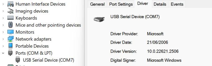

]]></description><link>https://community.m5stack.com/post/23439</link><guid isPermaLink="true">https://community.m5stack.com/post/23439</guid><dc:creator><![CDATA[Kombistack]]></dc:creator><pubDate>Tue, 23 Jan 2024 10:57:02 GMT</pubDate></item><item><title><![CDATA[Reply to Atom S3 lite Can&#x27;t connect to cloud mode on Mon, 22 Jan 2024 06:37:43 GMT]]></title><description><![CDATA[<p dir="auto"><a class="plugin-mentions-user plugin-mentions-a" href="/user/ajb2k3" aria-label="Profile: ajb2k3">@<bdi>ajb2k3</bdi></a> AM I right in assuming you are asking if I have the correct USB driver installed on my laptop as opposed to installing any usb driver to my Atom S3 lite?<br />
I already had installed the CP210xVCP_Windows driver on my laptop. I'm not even sure if this is the one I should be using for the Atom S3 lite. (I'm finding the documentation on the M5stack web site somewhat lacking...)<br />
In any case when I plug in the Atom S3 lite via usb cable to my laptop, the driver details are<br />
<img src="/assets/uploads/files/1705905283595-bec10984-00ff-4feb-898b-14ee9fe0182a-image.png" alt="0_1705905279500_bec10984-00ff-4feb-898b-14ee9fe0182a-image.png" class=" img-fluid img-markdown" /><br />
Could you please guide me any further?<br />
Thank you</p>
