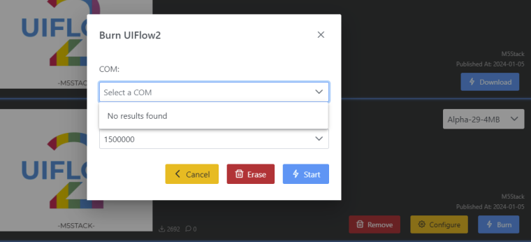

      The problem is NO com ports are showing. Com5 flashes when I first plug it in, but then disappears. Also, no lights come on anymore at all on the Core2 when plugged in either.

            @Deckyon is your Core2 com port (com 5 you mentioned) vanishes from Windows Device Manager too?

                @robski That is correct.

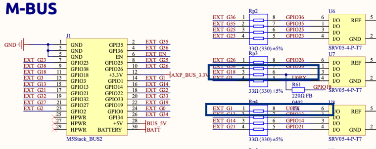

                    Having a similar issue with one of my two Core2 v1.1's I am wondering how this works exactly? I assume we are talking about the 4pin connector with (DP, DM, GND, 5V)? In which case DP/DM is TX/RX - although I am not sure which would be which.

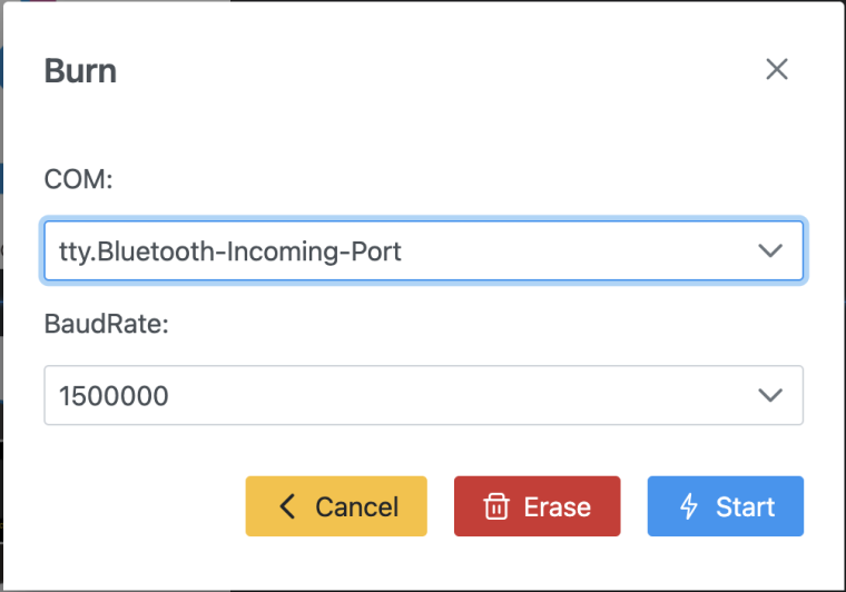

                    Does not seem to do anything. Although I do seem to on rare orations be able to get it into some state where the computer recognises it as a serial port. But it also seems not to actually work when I try to write to it.

                          None of the tricks with holding buttons does anything for the device I have that does not present a serial port over USB. While I'm mainly on macOS I can't make it do anything in Windows either. There I will just have an "Unknown USB Device (Device Descriptor Request Failed" entry in Device Manager.
                          So I'm more interested in how to connect directly to the internal TX/RX pins. But I am not entirely sure how to access them on this board.
                          Looking at the schematics more closely It seems the on-board connector is also for USB. But I am having a little trouble figuring out if any of the "M-BUS" pins connect. Maybe G1 and G18? G1 makes sense from the markings (TXD0). But G18 is marked as SCK (So a clock signal?) and G3 (marked RXD0) would make more sense.

                                Have you tried updating the CH9102 usb drivers?
                                yes, GPIO 1 and 3 are the pins you need to directly connect to.
                                if you look at the sticker on the base alt text
                                it sows which pins you need to use to bypass the CH9102.
                                If you have an arduino you need to program it as an ISP and then M5Burner should allow it to work instead of the CH9102 chip for programming.
                                Just remember that the Programmers TX must be connected G3 RXD and the programmers RX pin must be connected to G1 TXD pin along with the GND pin.
                                Connect 3v3 to the 3.3V pin or 5V to the 5V pin, do not connect both and do not have any other cables plugged in!
                                  Ah okay. My confusion is from here. That could indicate 1 and 18. But I realise now the wire that hits G18 is not what is labeled U0RX.

                                    @kristoffer Its easy to get confused because the ESP32 does not have fixed pin function but has a function matrix. stick to the pins marked on the labels.
