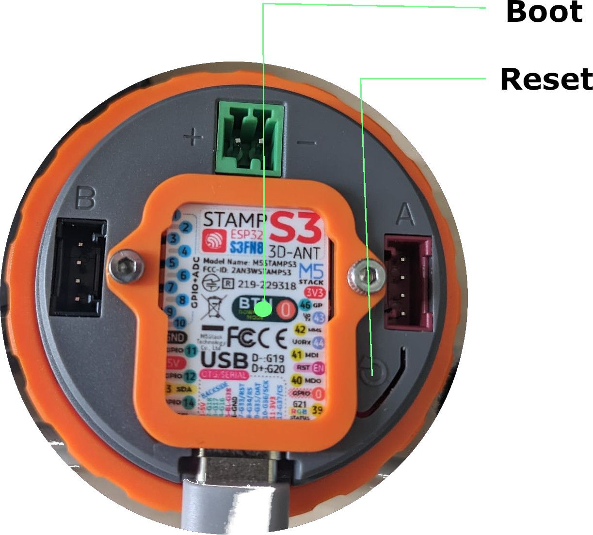

]]></description><link>https://community.m5stack.com/post/25412</link><guid isPermaLink="true">https://community.m5stack.com/post/25412</guid><dc:creator><![CDATA[HappyUser]]></dc:creator><pubDate>Mon, 27 May 2024 08:18:29 GMT</pubDate></item><item><title><![CDATA[Reply to M5Dial can not upload on Sun, 26 May 2024 10:36:04 GMT]]></title><description><![CDATA[<p dir="auto">I had to press the boot button and the reset button together. Just documenting for myself in case I do this again, I always sweat brick when I do this!</p>
<p dir="auto"><img src="/assets/uploads/files/1716719762534-stamp.jpeg" alt="Stamp.jpeg" class=" img-fluid img-markdown" /></p>
]]></description><link>https://community.m5stack.com/post/25408</link><guid isPermaLink="true">https://community.m5stack.com/post/25408</guid><dc:creator><![CDATA[ANON_USER]]></dc:creator><pubDate>Sun, 26 May 2024 10:36:04 GMT</pubDate></item><item><title><![CDATA[Reply to M5Dial can not upload on Mon, 12 Feb 2024 07:51:36 GMT]]></title><description><![CDATA[<p dir="auto"><a class="plugin-mentions-user plugin-mentions-a" href="/user/jofotoo" aria-label="Profile: jofotoo">@<bdi>jofotoo</bdi></a> said in <a href="/post/23743">M5Dial can not upload</a>:</p>
<p dir="auto"><a class="plugin-mentions-user plugin-mentions-a" href="/user/robski" aria-label="Profile: robski">@<bdi>robski</bdi></a> Where exactly is this button?</p>
<p dir="auto">its under sticker in the middle (its shown on the sticker)<br />
pressing it just doesn't feel /sounds same as reset button,<br />
boot button is very delicate and hard to feel</p>

]]></description><link>https://community.m5stack.com/post/23745</link><guid isPermaLink="true">https://community.m5stack.com/post/23745</guid><dc:creator><![CDATA[ajb2k3]]></dc:creator><pubDate>Sun, 11 Feb 2024 09:05:48 GMT</pubDate></item><item><title><![CDATA[Reply to M5Dial can not upload on Sun, 11 Feb 2024 05:00:36 GMT]]></title><description><![CDATA[<p dir="auto"><a class="plugin-mentions-user plugin-mentions-a" href="/user/robski" aria-label="Profile: robski">@<bdi>robski</bdi></a> Where exactly is this button?</p>

]]></description><link>https://community.m5stack.com/post/23556</link><guid isPermaLink="true">https://community.m5stack.com/post/23556</guid><dc:creator><![CDATA[ajb2k3]]></dc:creator><pubDate>Tue, 30 Jan 2024 16:27:34 GMT</pubDate></item><item><title><![CDATA[Reply to M5Dial can not upload on Tue, 30 Jan 2024 13:55:16 GMT]]></title><description><![CDATA[<p dir="auto">try to open M5Burner and load latest firmware, my M5Dial went to some unresponsive mode few times, press and hold boot button under sticker usually helps before its plugged in to usb - it is then detected under different com port.</p>
]]></description><link>https://community.m5stack.com/post/23551</link><guid isPermaLink="true">https://community.m5stack.com/post/23551</guid><dc:creator><![CDATA[robski]]></dc:creator><pubDate>Tue, 30 Jan 2024 13:55:16 GMT</pubDate></item><item><title><![CDATA[Reply to M5Dial can not upload on Tue, 23 Jan 2024 18:11:05 GMT]]></title><description><![CDATA[<p dir="auto"><a class="plugin-mentions-user plugin-mentions-a" href="/user/smartvisionary" aria-label="Profile: smartvisionary">@<bdi>smartvisionary</bdi></a> The device is of course an S3, which has a permanent bootloader installed by Espressif at their factory, so it is 'brick-proof'.<br />
