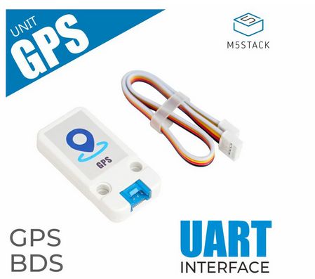

<p dir="auto">gps_0 = GPSUnit((33, 32))</p>
<p dir="auto">Did some fiddling, including finally figuring out how to make those changes, and it is now working!  Now, to do some programming and figure out how to change the strings into ints so I can do some math conversions.<br />
Thanks all!</p>
<p dir="auto">also, need to come up with a real UI as well.  But, I am just glad it is working.</p>

you have no Core2 bottom extension with uart blue portC on it.<br />
you are connecting UART type gps unit (blue port) in to Core2 default I2C port - which can and needs to be reconfigured to accept UART type of communication</p>

<p dir="auto">using red port I2c for unit with UART blue port needs to "tell" controller that it has to be configured with baudrate and parity matching gps unit  its not only pin config</p>

<p dir="auto">So, I am working on a simple first project using the GPS.  I am basing it off the one for the ENVII.  I have a Core2 with UIFLow 2.0  Below is the code.  It displays the labels, and displays what looks like data from the GPS, but it never changes and is not correct as if it is not finding satellites or even looking for them.  Is there something else I need to do in the code to initialize the GPS Unit correctly.  I am not a coder, this is literally my first time trying anything like this.  I got the Core2 and the GPS to start learning.  Yes, I have been outside and waited with clear skies and the Core2 has plenty of battery.</p>
<p dir="auto">have you tried any of factory examples  - easyloader or arduino  for gps just to prove that it is working?  also your GPS unit is the UART type - blue port correct?  Do you have bottom expansion with blue port on your Core2?  if no then you need to reconfigure it<br />
your code:  gps_0 = GPSUnit((13, 14))<br />
GPS connected to PortA   gps_0 = GPSUnit((33, 32))</p>
<p dir="auto"><img src="/assets/uploads/files/1707316514927-gpsuart.jpg" alt="0_1707316513495_gpsuart.jpg" class=" img-fluid img-markdown" /></p>
<p dir="auto"><a href="https://docs.m5stack.com/en/unit/gps" target="_blank" rel="noopener noreferrer nofollow ugc">GPS unit docs</a></p>
