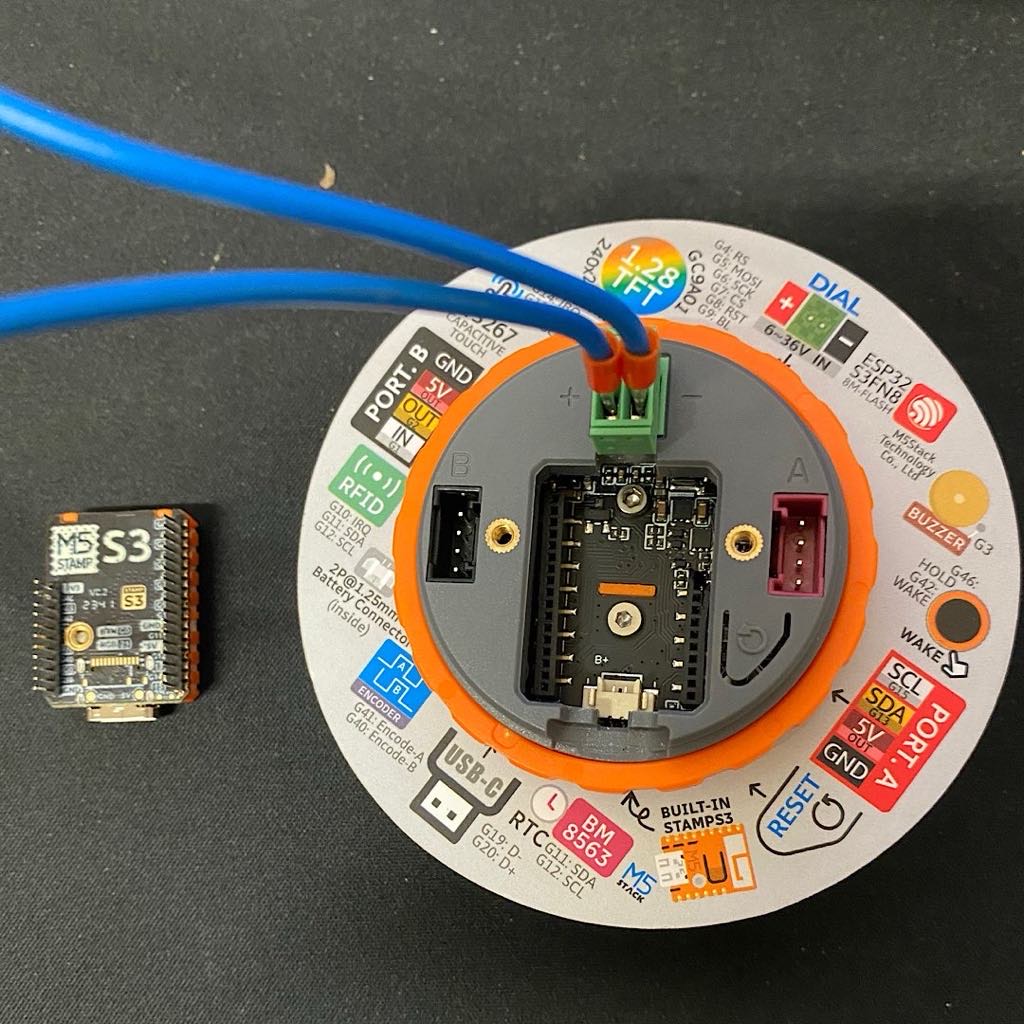

<p dir="auto">ok, I see. Well with the M5StampS3 (board) removed there is no ESP32S3, e.g. no micro controller - all that is left is some hardware: button, rotary encoder, LCD and connectors. In other words, w/o micro controller there is nothing to control the remaining hardware.</p>
<p dir="auto">What exactly do you want to achieve with your M5Dial with M5StampS3 removed?</p>

<img src="/assets/uploads/files/1708034670182-img_8469-resized.jpeg" alt="0_1708034667632_IMG_8469.jpeg" class=" img-fluid img-markdown" /></p>
<p dir="auto">When I do it like this, it doesn't turn on</p>

<p dir="auto">when you apply 6 - 36 V to the green DC power connector in the back M5Dial gets powered and starts to run.</p>
<p dir="auto">Thanks<br />
