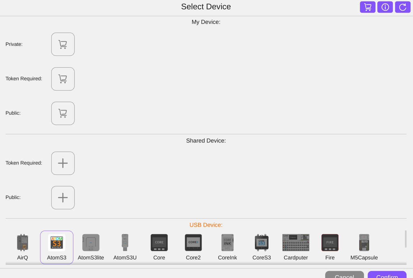

]]></description><link>https://community.m5stack.com/post/23974</link><guid isPermaLink="true">https://community.m5stack.com/post/23974</guid><dc:creator><![CDATA[ajb2k3]]></dc:creator><pubDate>Wed, 21 Feb 2024 11:54:30 GMT</pubDate></item><item><title><![CDATA[Reply to Is UIFlow 2.0 a dead project? on Wed, 21 Feb 2024 09:14:33 GMT]]></title><description><![CDATA[<p dir="auto">yes Uiflow 2.0 web needs Uiflow 2.0 firmware inside controller.</p>
]]></description><link>https://community.m5stack.com/post/23973</link><guid isPermaLink="true">https://community.m5stack.com/post/23973</guid><dc:creator><![CDATA[robski]]></dc:creator><pubDate>Wed, 21 Feb 2024 09:14:33 GMT</pubDate></item><item><title><![CDATA[Reply to Is UIFlow 2.0 a dead project? on Wed, 21 Feb 2024 08:59:24 GMT]]></title><description><![CDATA[<p dir="auto">So you are saying you need the UIFlow 2 firmware to use the UIFlow2 web workflow? Fair enough.</p>
<p dir="auto">Anyway, I accomplished my sketch using the old UIFlow. I will try to get UIFlow 2 to work later, but my next task is to see if I can get the Adruino IDE to work again. (It's been a few months since I used it, and along the way something, probably a Fedora upgrade, broke it.)</p>

In uiflow 2.0 you log in to same account.<br />
then it binds your device in to your account so as long it is configured with wifi access it is posible to be programmed via M5 cloud<br />
doesn't need to be connected by USB/ but can be.</p>

<p dir="auto">And I'm not sure what you mean by "binded", I have the 8 hex character API key, but I don't see anywhere to enter it.</p>
<p dir="auto">Nothing wrong with my setup, I can upload sketches to the Core 2 using UIFlow 1 using Wifi just fine.</p>

]]></description><link>https://community.m5stack.com/post/23968</link><guid isPermaLink="true">https://community.m5stack.com/post/23968</guid><dc:creator><![CDATA[robski]]></dc:creator><pubDate>Wed, 21 Feb 2024 08:24:48 GMT</pubDate></item><item><title><![CDATA[Reply to Is UIFlow 2.0 a dead project? on Wed, 21 Feb 2024 08:57:47 GMT]]></title><description><![CDATA[<p dir="auto">I started a project and the device type defaulted to an AtomS3. When I try to change the device to a Core 2, all "USB Devices" except the AtomS3 are greyed out. All the links to "My Device" just go to the store. "Shared Devices" ask for a 32-character token. All I have is a 8-charcater hex API key. Do I need to install v2.0.1-CORE2 firmware to get a 32-character key?</p>
<p dir="auto">If so, I'm stuck, because when I try to burn the v2.0.1-CORE2 firmware on my Core 2 it semi-bricks my device.</p>
<p dir="auto"><img src="/assets/uploads/files/1708502497969-af74ce46-a8eb-48bd-87d0-ceb943b608c6-image-resized.png" alt="0_1708502497071_af74ce46-a8eb-48bd-87d0-ceb943b608c6-image.png" class=" img-fluid img-markdown" /></p>
