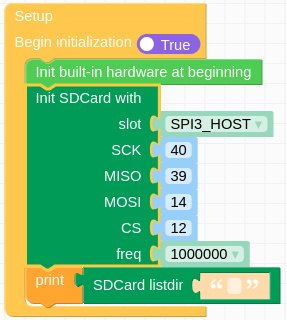

Seems there was a &lt;space&gt; in the "empty" listdir path <em>facepalm</em></p>
<p dir="auto">And it does require the SD card init block as you suggested.<br />
I thought that would be included in the "init built-in hardware" step, but the code shows otherwise.</p>
<p dir="auto">Even hot-swapping multiple works – neat.</p>
<p dir="auto">Thank you so much!</p>

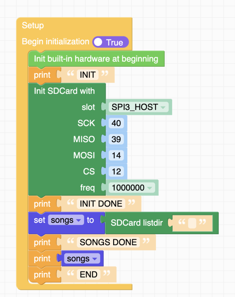

<p dir="auto">it seems that there is <em>something</em> happening.</p>
<p dir="auto"><strong>#1 Started with card</strong><br />
File "&lt;stdin&gt;", line 18, in &lt;module&gt;<br />
File "&lt;stdin&gt;", line 11, in setup<br />
OSError: [Errno 22] EINVAL</p>
<p dir="auto"><strong>#2 Removing the card</strong><br />
File "&lt;stdin&gt;", line 9, in setup<br />
File "hardware/sdcard.py", line 19, in SDCard<br />
OSError: [Errno 116] ETIMEDOUT: ESP_ERR_TIMEOUT</p>
<p dir="auto"><strong>#3 Running it again</strong><br />
File "hardware/sdcard.py", line 16, in SDCard<br />
OSError: (-259, 'ESP_ERR_INVALID_STATE')</p>
<p dir="auto">Inserting the card back at runtime changes the error back to #1</p>
<p dir="auto">Pretty sure the solution lies somewhere in correctly formatting the card.<br />
That's why I would like to format it with the ESP itself.</p>
<p dir="auto"><img src="/assets/uploads/files/1708604625172-bildschirmfoto-2024-02-22-um-13.23.31-resized.png" alt="0_1708604623889_Bildschirmfoto 2024-02-22 um 13.23.31.png" class=" img-fluid img-markdown" /></p>

<p dir="auto">try adding the <code>Init SDCard with</code> block before accessing the SD card. See below.</p>
<p dir="auto"><img src="/assets/uploads/files/1708578174221-ui2_m5cardputer_sdcard_20240222.png" alt="0_1708578172291_UI2_M5Cardputer_SDCard_20240222.png" class=" img-fluid img-markdown" /></p>
<p dir="auto">Thanks<br />
Felix</p>

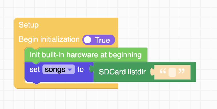

<blockquote>
<p dir="auto">What code are you using?</p>
</blockquote>
<p dir="auto">Basically just UIFlow2 &gt; SDCard &gt; listdir</p>
<p dir="auto">Or the CLI in UIFlow for the os.listdir()</p>
<p dir="auto"><img src="/assets/uploads/files/1708551066023-bildschirmfoto-2024-02-21-um-22.28.18-resized.png" alt="0_1708551064186_Bildschirmfoto 2024-02-21 um 22.28.18.png" class=" img-fluid img-markdown" /></p>
