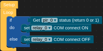

<p dir="auto"><a href="https://docs.m5stack.com/en/unit/PIR" target="_blank" rel="noopener noreferrer nofollow ugc">PIR unit</a> only needs one <strong>input</strong> GPIO and the <a href="https://docs.m5stack.com/en/unit/relay" target="_blank" rel="noopener noreferrer nofollow ugc">relay unit</a> only needs one <strong>output</strong> GPIO. You can combine both to the same Groove port with default GPIOs using a <a href="https://docs.m5stack.com/en/accessory/converter/grove_t" target="_blank" rel="noopener noreferrer nofollow ugc">Groove-T</a> connector.<br />
Below UIFlow blocks turn the relay on and off, depending on what the PIR sensor reports:</p>
<p dir="auto"><img src="/assets/uploads/files/1708693639251-ui1_stamp_pir_relay_20240223.png" alt="0_1708693638060_UI1_Stamp_PIR_Relay_20240223.png" class=" img-fluid img-markdown" /></p>
