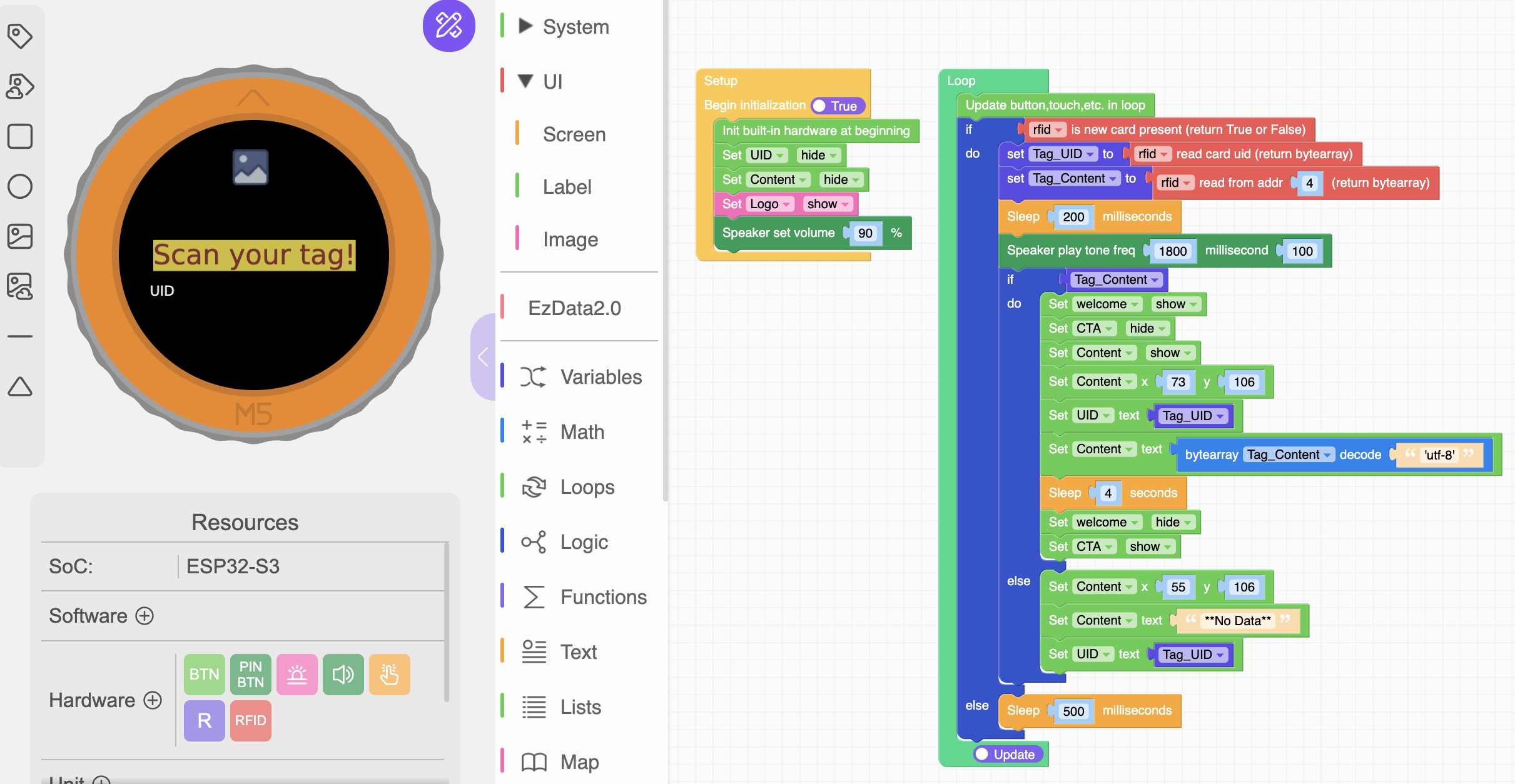

<?xml version="1.0" encoding="UTF-8"?><rss xmlns:dc="http://purl.org/dc/elements/1.1/" xmlns:content="http://purl.org/rss/1.0/modules/content/" xmlns:atom="http://www.w3.org/2005/Atom" version="2.0"><channel><title><![CDATA[M5Dial UiFlow 2.0.1 RFID scanning issue]]></title><description><![CDATA[<p dir="auto">I'm testing out rfid scan feature on M5Dial. I have the blockly code as in the screenshot attached. When I run the code, the very first rfid card scan works fine in reading the content of the card. Recurring rfid card scan takes either 20-50 seconds or just don't get scanned.<br />
And every now and then I get ETIMEDOUT error. I tried a while loop to look for a RFID card presence before reading from address 4. Seems to have helped with timeout error but still seeing significant delays beyond the first scan. Appreciate any help.</p>

]]></description><link>https://community.m5stack.com/post/24162</link><guid isPermaLink="true">https://community.m5stack.com/post/24162</guid><dc:creator><![CDATA[kumsat]]></dc:creator><pubDate>Tue, 27 Feb 2024 05:50:12 GMT</pubDate></item><item><title><![CDATA[Reply to M5Dial UiFlow 2.0.1 RFID scanning issue on Mon, 26 Feb 2024 08:15:46 GMT]]></title><description><![CDATA[<p dir="auto">Hello <a class="plugin-mentions-user plugin-mentions-a" href="/user/kumsat" aria-label="Profile: kumsat">@<bdi>kumsat</bdi></a></p>
<p dir="auto">try adding a <code>rfid close</code> block when you are done reading from addr. E.g. before the 200 ms delay.</p>
