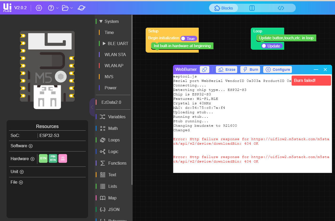

<?xml version="1.0" encoding="UTF-8"?><rss xmlns:dc="http://purl.org/dc/elements/1.1/" xmlns:content="http://purl.org/rss/1.0/modules/content/" xmlns:atom="http://www.w3.org/2005/Atom" version="2.0"><channel><title><![CDATA[WebBurner from UI FLOW2 error]]></title><description><![CDATA[<p dir="auto">Trying to burn the firmware from using the web burner and have an error.<br />
Bug on the uiflow side?</p>
<p dir="auto"><img src="/assets/uploads/files/1709837990866-7d66417a-0a71-4dd3-8277-4efd62d6bab2-image-resized.png" alt="0_1709837989689_7d66417a-0a71-4dd3-8277-4efd62d6bab2-image.png" class=" img-fluid img-markdown" /></p>

<p dir="auto">FYI: I've checked the URL you posted on VirusTotal and it did not indicate a problem. See result <a href="https://www.virustotal.com/gui/url/42d2cd13bf7675d54249f7490a8cf0d57e7c72357f290961c660423e2fbf68e2" target="_blank" rel="noopener noreferrer nofollow ugc">here</a>.</p>

]]></description><link>https://community.m5stack.com/post/24418</link><guid isPermaLink="true">https://community.m5stack.com/post/24418</guid><dc:creator><![CDATA[felmue]]></dc:creator><pubDate>Mon, 18 Mar 2024 01:40:06 GMT</pubDate></item><item><title><![CDATA[Reply to WebBurner from UI FLOW2 error on Tue, 12 Mar 2024 20:00:02 GMT]]></title><description><![CDATA[<p dir="auto">If you are getting this for a while, you need to clear out your temperory files and data and reset the browsers. it could be one of the temp files blocking the site</p>
]]></description><link>https://community.m5stack.com/post/24337</link><guid isPermaLink="true">https://community.m5stack.com/post/24337</guid><dc:creator><![CDATA[ajb2k3]]></dc:creator><pubDate>Tue, 12 Mar 2024 20:00:02 GMT</pubDate></item><item><title><![CDATA[Reply to WebBurner from UI FLOW2 error on Tue, 12 Mar 2024 16:34:22 GMT]]></title><description><![CDATA[<p dir="auto">I resolved my problem by downloading the non-online version of UIUFlow2 Burner for the Cardputer, then burned successfully, and was then able to continue using the browser-based UIFlow V2 to work on my project.</p>

<p dir="auto">I thought it was me. can confirm I had the same yesterday (11/3/2024)</p>
]]></description><link>https://community.m5stack.com/post/24328</link><guid isPermaLink="true">https://community.m5stack.com/post/24328</guid><dc:creator><![CDATA[zoner]]></dc:creator><pubDate>Tue, 12 Mar 2024 02:42:42 GMT</pubDate></item><item><title><![CDATA[Reply to WebBurner from UI FLOW2 error on Mon, 11 Mar 2024 18:22:06 GMT]]></title><description><![CDATA[<p dir="auto">I've been getting this error for days, including today. I assume the UIflow2 servers are down and that I should keep trying. I can't think of anything that I am doing that could cause this error. I had been workng fine previous to about a week ago.</p>
]]></description><link>https://community.m5stack.com/post/24324</link><guid isPermaLink="true">https://community.m5stack.com/post/24324</guid><dc:creator><![CDATA[BigAl2301]]></dc:creator><pubDate>Mon, 11 Mar 2024 18:22:06 GMT</pubDate></item><item><title><![CDATA[Reply to WebBurner from UI FLOW2 error on Fri, 08 Mar 2024 06:44:22 GMT]]></title><description><![CDATA[<p dir="auto">Server in accessable, It happens from time to time.</p>
]]></description><link>https://community.m5stack.com/post/24297</link><guid isPermaLink="true">https://community.m5stack.com/post/24297</guid><dc:creator><![CDATA[ajb2k3]]></dc:creator><pubDate>Fri, 08 Mar 2024 06:44:22 GMT</pubDate></item></channel></rss>
