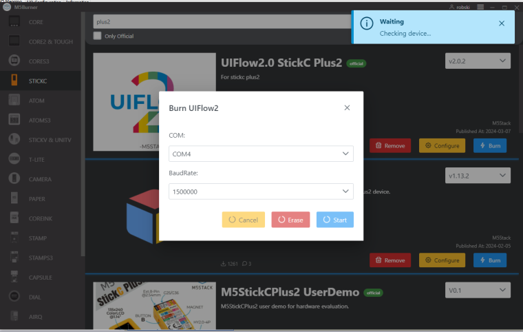

<?xml version="1.0" encoding="UTF-8"?><rss xmlns:dc="http://purl.org/dc/elements/1.1/" xmlns:content="http://purl.org/rss/1.0/modules/content/" xmlns:atom="http://www.w3.org/2005/Atom" version="2.0"><channel><title><![CDATA[M5StickC Plus2 - uiflow2 firmware burn issue - (waiting, checking device)]]></title><description><![CDATA[<p dir="auto">I see below (waiting, checking device) for ages when trying to burn latest firmware or any of Uiflow2 firmwares</p>
<p dir="auto"><img src="/assets/uploads/files/1710411301265-m5scp2_0-resized.png" alt="0_1710411299588_m5scp2_0.png" class=" img-fluid img-markdown" /></p>
<p dir="auto">I can do erase, I can burn uiflow1 firmware, i can load code via Arduino  from some reason its not happy to start firmware burn process.<br />
Any pointers what to try?</p>
]]></description><link>https://community.m5stack.com/topic/6209/m5stickc-plus2-uiflow2-firmware-burn-issue-waiting-checking-device</link><generator>RSS for Node</generator><lastBuildDate>Fri, 08 May 2026 14:38:43 GMT</lastBuildDate><atom:link href="https://community.m5stack.com/topic/6209.rss" rel="self" type="application/rss+xml"/><pubDate>Thu, 14 Mar 2024 10:20:44 GMT</pubDate><ttl>60</ttl><item><title><![CDATA[Reply to M5StickC Plus2 - uiflow2 firmware burn issue - (waiting, checking device) on Fri, 15 Mar 2024 07:59:26 GMT]]></title><description><![CDATA[<p dir="auto">it worked on another machine, burned latest firmware ok.</p>

<p dir="auto">Switch the computer off then on again as something is blocking access to the com port</p>
<p dir="auto">will try, but its bizarre as anything else i try works, so port is open for action</p>

]]></description><link>https://community.m5stack.com/post/24374</link><guid isPermaLink="true">https://community.m5stack.com/post/24374</guid><dc:creator><![CDATA[ajb2k3]]></dc:creator><pubDate>Thu, 14 Mar 2024 12:19:14 GMT</pubDate></item></channel></rss>
