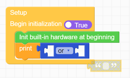

<?xml version="1.0" encoding="UTF-8"?><rss xmlns:dc="http://purl.org/dc/elements/1.1/" xmlns:content="http://purl.org/rss/1.0/modules/content/" xmlns:atom="http://www.w3.org/2005/Atom" version="2.0"><channel><title><![CDATA[Bug that prevents you from using string blocks as an input in the or block]]></title><description><![CDATA[<p dir="auto">I want to use the <strong>number</strong> and <strong>string</strong> blocks as inputs for the <strong>or</strong> and <strong>and</strong> blocks.<br />
<img src="/assets/uploads/files/1710990513956-82e084e5-f6d6-49e4-906f-58fb81ec7328-image.png" alt="0_1710990527180_82e084e5-f6d6-49e4-906f-58fb81ec7328-image.png" class=" img-fluid img-markdown" /></p>
]]></description><link>https://community.m5stack.com/topic/6241/bug-that-prevents-you-from-using-string-blocks-as-an-input-in-the-or-block</link><generator>RSS for Node</generator><lastBuildDate>Wed, 29 Apr 2026 03:45:49 GMT</lastBuildDate><atom:link href="https://community.m5stack.com/topic/6241.rss" rel="self" type="application/rss+xml"/><pubDate>Thu, 21 Mar 2024 03:18:24 GMT</pubDate><ttl>60</ttl><item><title><![CDATA[Reply to Bug that prevents you from using string blocks as an input in the or block on Thu, 21 Mar 2024 19:53:11 GMT]]></title><description><![CDATA[<p dir="auto">In python you can use strings with the <strong>or</strong> and <strong>and</strong> keywords. The program sends a TCP request and prints the response, but if it fails it prints connection error.</p>

And/or are logical functions, they only take true/false as inputs and returns a true/false.<br />
Add/subtract are arithmetic functions, they only take numbers as inputs and returns a number.</p>
<p dir="auto">You will need to convert your string or number into a true/false value first.<br />
The "IF" block can do this as it returns true/false.<br />
Eg "If number=0 return false else return true"</p>
