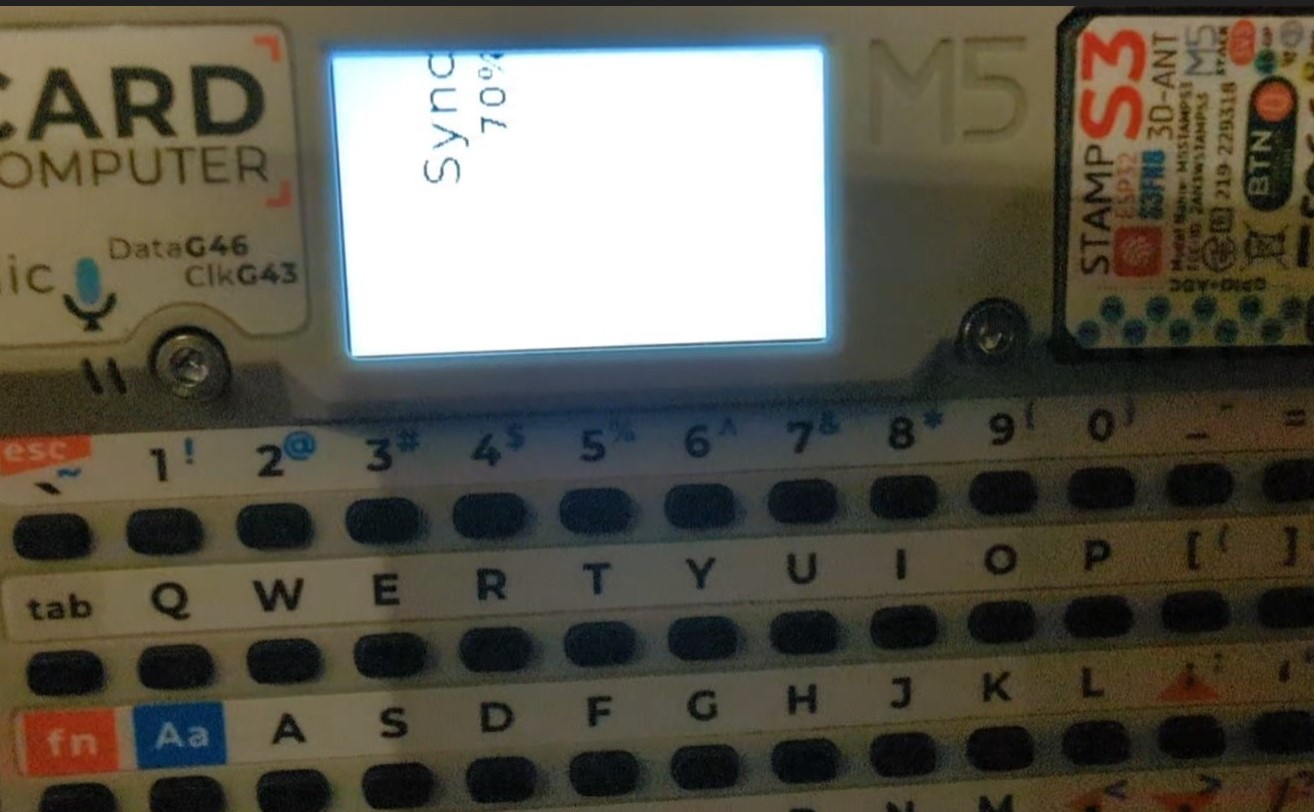

<?xml version="1.0" encoding="UTF-8"?><rss xmlns:dc="http://purl.org/dc/elements/1.1/" xmlns:content="http://purl.org/rss/1.0/modules/content/" xmlns:atom="http://www.w3.org/2005/Atom" version="2.0"><channel><title><![CDATA[UIFLow2.0 Cardputer Run vs. Download screen flip]]></title><description><![CDATA[<p dir="auto">Hello Everyone, Hope we can solve this issue. I am experiencing an issue where download .py is rotated on the Cardputer screen. Run is fine. See in screen shot below. The actual load screen is flipped -90deg.</p>
<p dir="auto">Is there a fix for this? Or workaround ?I could not find any reason in the py code for this. Annoying because .py apps are not portable. Thanks for reading!<br />

]]></description><link>https://community.m5stack.com/topic/6289/uiflow2-0-cardputer-run-vs-download-screen-flip</link><generator>RSS for Node</generator><lastBuildDate>Wed, 29 Apr 2026 22:12:16 GMT</lastBuildDate><atom:link href="https://community.m5stack.com/topic/6289.rss" rel="self" type="application/rss+xml"/><pubDate>Tue, 02 Apr 2024 01:28:43 GMT</pubDate><ttl>60</ttl><item><title><![CDATA[Reply to UIFLow2.0 Cardputer Run vs. Download screen flip on Sun, 01 Dec 2024 14:18:06 GMT]]></title><description><![CDATA[<p dir="auto"><a class="plugin-mentions-user plugin-mentions-a" href="/user/dumpsterfire" aria-label="Profile: DumpsterFire">@<bdi>DumpsterFire</bdi></a> add a screen rotation 90 degree builtin statement, download and test again.</p>
