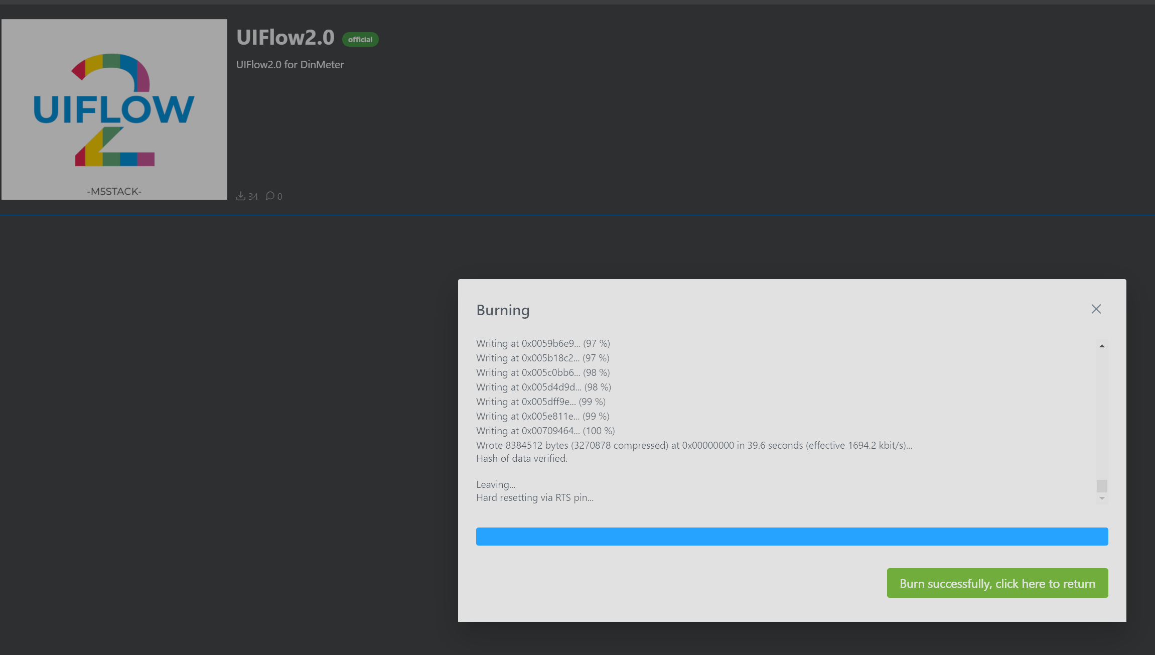

<?xml version="1.0" encoding="UTF-8"?><rss xmlns:dc="http://purl.org/dc/elements/1.1/" xmlns:content="http://purl.org/rss/1.0/modules/content/" xmlns:atom="http://www.w3.org/2005/Atom" version="2.0"><channel><title><![CDATA[My M5DINMeter is not working.]]></title><description><![CDATA[<p dir="auto">I have an M5DinMeter.<br />
I burned the firmware using the M5 Burner to use UIFLOW.<br />
I get a message saying successful, but nothing is showing on the screen of the M5DinMeter.<br />
What should I check?</p>
<p dir="auto">DiaMeter Demo worked well.</p>
