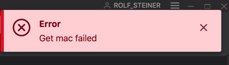

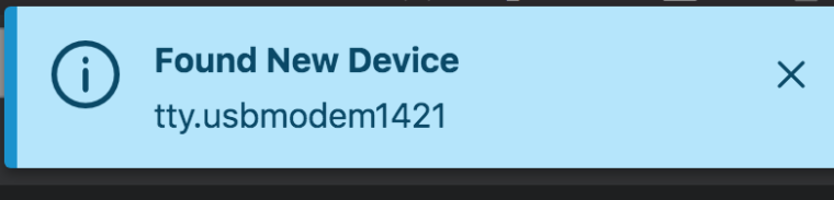

Results after changing USB cable:<br />
<img src="/assets/uploads/files/1715115249095-60ac29dc-918d-4eb8-b8ea-6a4b5ca5441c-captura-de-pantalla-2024-05-07-a-las-17.52.46-resized.png" alt="0_1715115244559_60ac29dc-918d-4eb8-b8ea-6a4b5ca5441c-Captura de pantalla 2024-05-07 a las 17.52.46.png" class=" img-fluid img-markdown" /> Captura de pantalla 2024-05-07 a las 17.52.46</p>
<p dir="auto">looks like the device are connected in a right manner, but half second later appears the "Get mac failed" in red rectangle.</p>
<p dir="auto">Weird thing is the message inside the "Burn UIFIow2" area, in every "cancel, erase, start" button the <em>loading circle</em> keeps moving eternally.....</p>

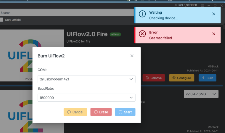

good morning mate!<br />
thanks for all you support!!</p>
<p dir="auto">If I follows the youtube link, step by step, after the actions required at the second 44, this appears in my screen:<br />
<img src="/assets/uploads/files/1715092717588-eca05025-c81a-40df-acfb-8b2084bb10aa-captura-de-pantalla-2024-05-07-a-las-11.31.05-resized.png" alt="0_1715092713857_eca05025-c81a-40df-acfb-8b2084bb10aa-Captura de pantalla 2024-05-07 a las 11.31.05.png" class=" img-fluid img-markdown" /> Captura de pantalla 2024-05-07 a las 11.31.05</p>
<p dir="auto">I´m lost..... I cant understand why doesnt  recognize the cardputer....</p>

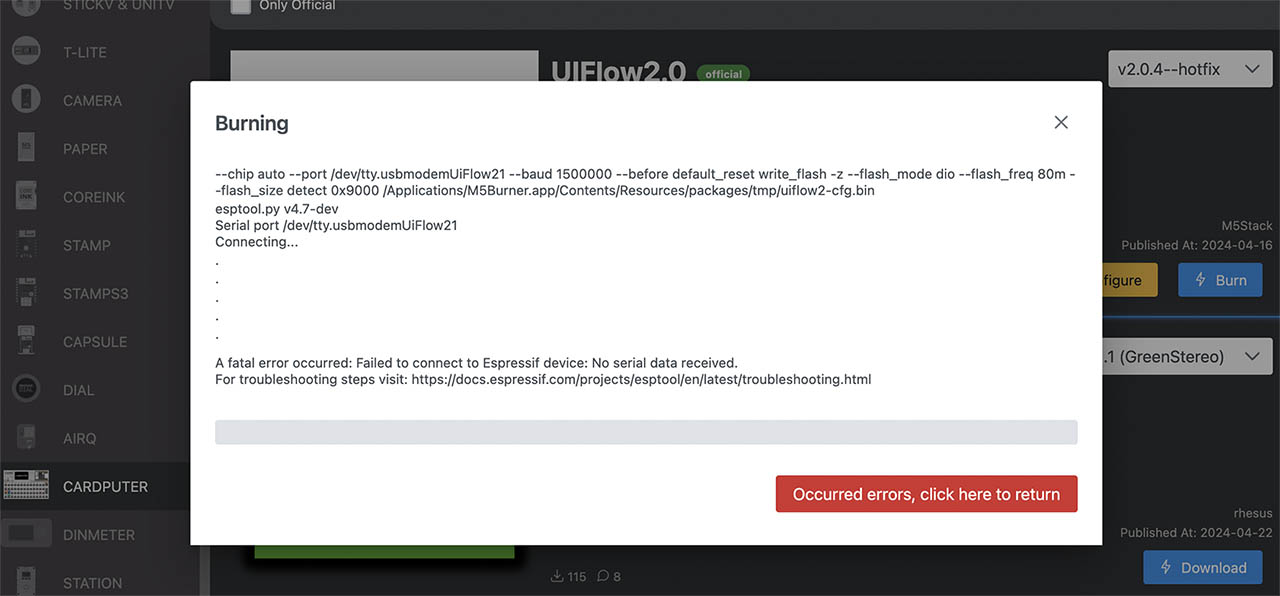

<p dir="auto"><img src="/assets/uploads/files/1715008191648-57290239-d78d-4c19-80fa-a34a0a2cc92a-captura-de-pantalla-2024-05-06-a-las-12.07.47-resized.png" alt="0_1715008188829_57290239-d78d-4c19-80fa-a34a0a2cc92a-Captura de pantalla 2024-05-06 a las 12.07.47.png" class=" img-fluid img-markdown" /> Captura de pantalla 2024-05-06 a las 12.07.47</p>
<p dir="auto">my last update is this status now.....</p>
<p dir="auto">after all my intents to fix this situation, now trying to "burn" appears this:</p>
<p dir="auto"><img src="/assets/uploads/files/1715014756571-27561bf8-3146-45fd-9229-e1b016d8b072-captura-de-pantalla-2024-05-06-a-las-13.57.27-resized.png" alt="0_1715014753140_27561bf8-3146-45fd-9229-e1b016d8b072-Captura de pantalla 2024-05-06 a las 13.57.27.png" class=" img-fluid img-markdown" /> Captura de pantalla 2024-05-06 a las 13.57.27</p>
<p dir="auto">sad thing, this frustrates a lot.</p>
<p dir="auto">in other hand, i can't format any Micro SD if I put one in the cardputer....</p>

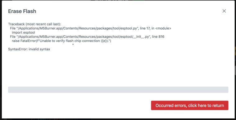

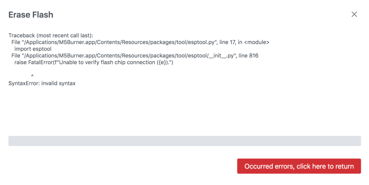

<p dir="auto">Erase Flash</p>
<p dir="auto">Traceback (most recent call last):<br />
File "/Applications/M5Burner.app/Contents/Resources/packages/tool/esptool.py", line 17, in &lt;module&gt;<br />
import esptool<br />
File "/Applications/M5Burner.app/Contents/Resources/packages/tool/esptool/<strong>init</strong>.py", line 816<br />
raise FatalError(f"Unable to verify flash chip connection ({e}).")</p>
<pre><code>           ^
</code></pre>
<p dir="auto">SyntaxError: invalid syntax</p>
<p dir="auto"><img src="/assets/uploads/files/1714969622101-4cfa4ae8-3cae-4b48-a034-a0e434728d9e-captura-de-pantalla-2024-05-06-a-las-01.24.26-resized.png" alt="0_1714969618004_4cfa4ae8-3cae-4b48-a034-a0e434728d9e-Captura de pantalla 2024-05-06 a las 01.24.26.png" class=" img-fluid img-markdown" /> Captura de pantalla 2024-05-06 a las 01.24.26</p>
<p dir="auto">help please</p>
