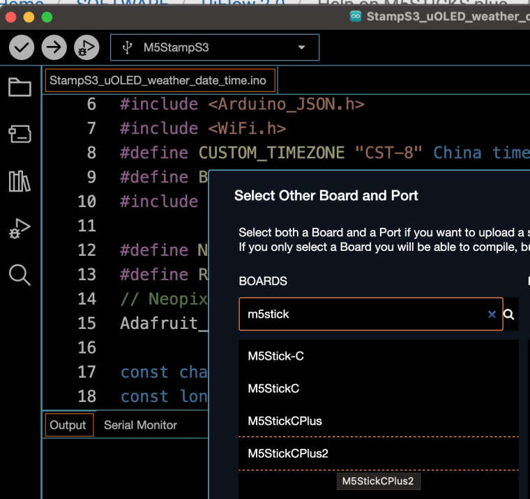

]]></description><link>https://community.m5stack.com/post/25011</link><guid isPermaLink="true">https://community.m5stack.com/post/25011</guid><dc:creator><![CDATA[ajb2k3]]></dc:creator><pubDate>Wed, 01 May 2024 05:58:59 GMT</pubDate></item><item><title><![CDATA[Reply to Help on M5STICKS plus. on Tue, 30 Apr 2024 18:00:53 GMT]]></title><description><![CDATA[<p dir="auto"><a class="plugin-mentions-user plugin-mentions-a" href="/user/k05007" aria-label="Profile: k05007">@<bdi>k05007</bdi></a> ESP32 is the microcontroller chip in all M5Stack controllers.<br />
"M5StickCPlus2" is the board definition. You could program that board as ESP32 but it would require a ton of support libraries, just not worth it.<br />
Using the M5StickCPlus2 library makes it easier to use in Arduino IDE .<br />
In Arduino IDE choose M5StickCPlus2 in the communication window</p>
<p dir="auto"><img src="/assets/uploads/files/1714500006270-screenshot-2024-04-30-at-1.58.15-pm-resized.jpg" alt="0_1714499965727_Screenshot 2024-04-30 at 1.58.15 PM.jpg" class=" img-fluid img-markdown" /></p>
]]></description><link>https://community.m5stack.com/post/25005</link><guid isPermaLink="true">https://community.m5stack.com/post/25005</guid><dc:creator><![CDATA[teastain]]></dc:creator><pubDate>Tue, 30 Apr 2024 18:00:53 GMT</pubDate></item><item><title><![CDATA[Reply to Help on M5STICKS plus. on Tue, 30 Apr 2024 15:21:55 GMT]]></title><description><![CDATA[<p dir="auto">If you add M5Stack library and modules you can use Arduino to program any M5Stack controller</p>
