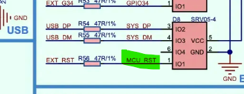

<?xml version="1.0" encoding="UTF-8"?><rss xmlns:dc="http://purl.org/dc/elements/1.1/" xmlns:content="http://purl.org/rss/1.0/modules/content/" xmlns:atom="http://www.w3.org/2005/Atom" version="2.0"><channel><title><![CDATA[External Reset for Core2]]></title><description><![CDATA[<p dir="auto">Hi, I am using a Core2 V1.1 and I want to have an external Watchdog circuit that can cause a reset for the Core2 in case it gets stuck.  I cannot find documentation on the RST pin.  Can I just pull it low to GND to cause a reset on the Core2?</p>
]]></description><link>https://community.m5stack.com/topic/6410/external-reset-for-core2</link><generator>RSS for Node</generator><lastBuildDate>Fri, 08 May 2026 07:40:51 GMT</lastBuildDate><atom:link href="https://community.m5stack.com/topic/6410.rss" rel="self" type="application/rss+xml"/><pubDate>Thu, 02 May 2024 14:35:07 GMT</pubDate><ttl>60</ttl><item><title><![CDATA[Reply to External Reset for Core2 on Thu, 02 May 2024 15:01:47 GMT]]></title><description><![CDATA[<p dir="auto">Looking at the <a href="https://m5stack.oss-cn-shenzhen.aliyuncs.com/resource/docs/schematic/Core/CORE2_V1.0_SCH.pdf" target="_blank" rel="noopener noreferrer nofollow ugc">schematics</a>, the RST pin if pulled low, will do the same thing as if S1 is pressed. I assume S1 is the reset button.</p>
<p dir="auto"><img src="/assets/uploads/files/1714661819436-c0ff6da9-61b2-4c66-b20b-bf6cbb1b267e-image.png" alt="0_1714661816348_c0ff6da9-61b2-4c66-b20b-bf6cbb1b267e-image.png" class=" img-fluid img-markdown" /></p>
<p dir="auto"><img src="/assets/uploads/files/1714661833578-64f32551-a132-4a03-8cf5-b66d60089d5b-image.png" alt="0_1714661829129_64f32551-a132-4a03-8cf5-b66d60089d5b-image.png" class=" img-fluid img-markdown" /></p>
<p dir="auto">I don't have a CORE2, but from experience with some other M5Stack products the function of the reset button depends on whether the device is on external power (e.g. USB) or on battery power.<br />
External power: restarts , battery power: shuts down. (but that is something you can test yourself)</p>
