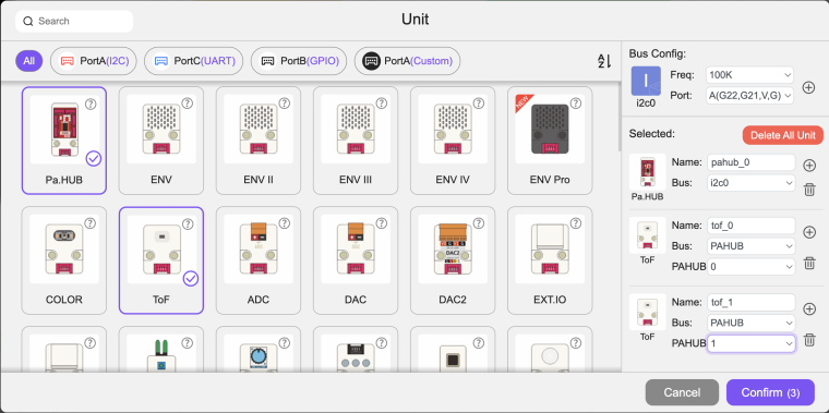

<p dir="auto">The TOFs.</p>
<p dir="auto">Ok so you need to have the code/libraries to both access the TOF sensors and the Host PAHUB controller.</p>
<p dir="auto">I once wrote a guide on how to connect 2 TOFs via a PAHub to an M5Stack controller but it looks to have gone missing.</p>
<p dir="auto"><img src="/assets/uploads/files/1714890353119-screenshot-2024-05-05-at-07.25.27-resized.png" alt="0_1714890349525_Screenshot 2024-05-05 at 07.25.27.png" class=" img-fluid img-markdown" /></p>
<p dir="auto">This is how the TOFs must be configured in UIFLow2.</p>
<p dir="auto">Here is the Project Zone Link just for reading the 2 Time of Flight Units. <a href="https://uiflow2.m5stack.com/?pkey=bf8abdb1dd8c4e47b52de320c9206ecc" target="_blank" rel="noopener noreferrer nofollow ugc">https://uiflow2.m5stack.com/?pkey=bf8abdb1dd8c4e47b52de320c9206ecc</a></p>
