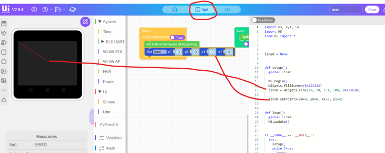

]]></description><link>https://community.m5stack.com/post/25074</link><guid isPermaLink="true">https://community.m5stack.com/post/25074</guid><dc:creator><![CDATA[YurShev]]></dc:creator><pubDate>Mon, 06 May 2024 16:16:33 GMT</pubDate></item><item><title><![CDATA[Reply to UiFlow 2.0 Graphics on Mon, 06 May 2024 11:13:53 GMT]]></title><description><![CDATA[<p dir="auto">More generally, if you what to know the python-code just use the <a href="https://uiflow2.m5stack.com/" target="_blank" rel="noopener noreferrer nofollow ugc">UIFlow Website</a> as API reference/resource. Simply construct your desired function etc with UIFlow-blocks and then to see the associated python code use "split view" like shown here:</p>
<p dir="auto"><img src="/assets/uploads/files/1714993977896-dc59c495-4117-44f6-b14b-e1f4ed7a897d-image-resized.png" alt="0_1714993975018_dc59c495-4117-44f6-b14b-e1f4ed7a897d-image.png" class=" img-fluid img-markdown" /></p>
