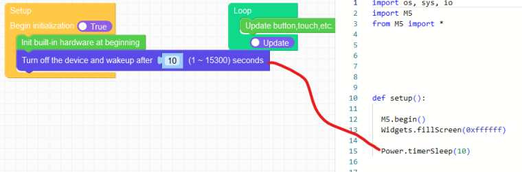

<img src="/assets/uploads/files/1715000855892-0f010509-2d06-41fa-9bc3-6ed2bfd08074-image-resized.png" alt="0_1715000853459_0f010509-2d06-41fa-9bc3-6ed2bfd08074-image.png" class=" img-fluid img-markdown" /></p>
<p dir="auto">I assume the <strong>Power.timerSleep()</strong> function is replacing the <strong>UIFlow 1.x.. power.restart_after_seconds()</strong> which works as expected.</p>
<p dir="auto">The new function seems to only put the ESP32 in sleep mode and <em>not</em> switching off the hole board. It does work partly as it do restart the board after the given amount of seconds.<br />
As far as I have figured out it do in fact initialize the BM8365 RTC to interrupt at the given seconds but it does not (probably) set GPIO12 low to switch off the "board-power".</p>
