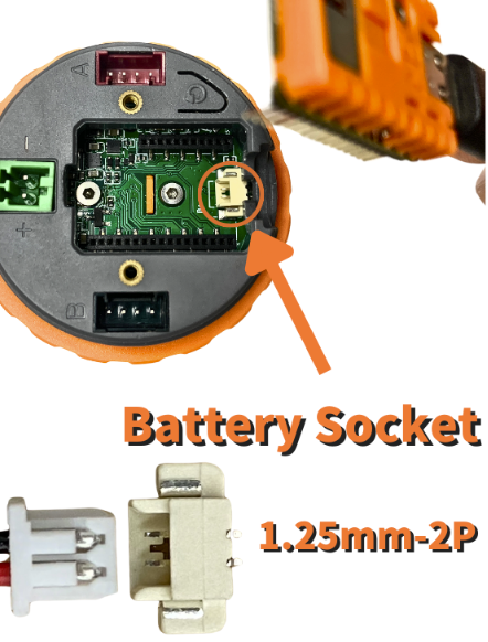

]]></description><link>https://community.m5stack.com/post/25181</link><guid isPermaLink="true">https://community.m5stack.com/post/25181</guid><dc:creator><![CDATA[HappyUser]]></dc:creator><pubDate>Sat, 11 May 2024 11:06:56 GMT</pubDate></item><item><title><![CDATA[Reply to M5Dial, high power consumption during deep sleep. on Fri, 10 May 2024 11:17:01 GMT]]></title><description><![CDATA[<p dir="auto">Try to supply it with a battery (disconnect the source from the Vin green conn.)  and measure the consumption from the battery while having the unit in sleep mode.</p>
<p dir="auto"><img src="/assets/uploads/files/1715339663856-932e2098-6e06-4a8b-9ddb-83373dd5aa34-image.png" alt="0_1715339661397_932e2098-6e06-4a8b-9ddb-83373dd5aa34-image.png" class=" img-fluid img-markdown" /></p>
