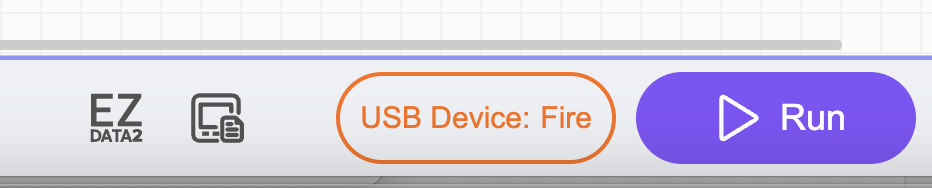

<p dir="auto">I do have probably basic question. I want to use UIFlow2.0<br />
I am getting error:</p>
<pre><code>ImportError: no module named 'M5'
</code></pre>
<p dir="auto">I have used M5 burner and the latest is 2.0.5 for FIRE.<br />
I have selected correct device as well.</p>
<p dir="auto"><img src="/assets/uploads/files/1715497410255-ca553fff-a13d-4484-9459-7dcf6d78e2ef-image-resized.png" alt="0_1715497408292_ca553fff-a13d-4484-9459-7dcf6d78e2ef-image.png" class=" img-fluid img-markdown" /></p>
<p dir="auto">Where I get "firmware" which includes correct modules?<br />
I do simply assume it is old FW as using UIFlow works. UIFlow does import <code>M5stack</code> UIFlow2.0 imports <code>M5</code>.</p>
<p dir="auto">Thank you for any help.</p>
]]></description><link>https://community.m5stack.com/topic/6459/importerror-no-module-named-m5-burned-uiflow2-0-2-0-5-with-fire</link><generator>RSS for Node</generator><lastBuildDate>Sun, 17 May 2026 01:59:35 GMT</lastBuildDate><atom:link href="https://community.m5stack.com/topic/6459.rss" rel="self" type="application/rss+xml"/><pubDate>Sun, 12 May 2024 07:08:41 GMT</pubDate><ttl>60</ttl><item><title><![CDATA[Reply to ImportError: no module named &#x27;M5&#x27; burned UIFlow2.0 - 2.0.5 with Fire on Sun, 12 May 2024 11:42:24 GMT]]></title><description><![CDATA[<p dir="auto">Make sure you erase and burn the correct firmware for the controller, UIFlow and uiflow2 are not the same</p>
]]></description><link>https://community.m5stack.com/post/25196</link><guid isPermaLink="true">https://community.m5stack.com/post/25196</guid><dc:creator><![CDATA[ajb2k3]]></dc:creator><pubDate>Sun, 12 May 2024 11:42:24 GMT</pubDate></item><item><title><![CDATA[Reply to ImportError: no module named &#x27;M5&#x27; burned UIFlow2.0 - 2.0.5 with Fire on Sun, 12 May 2024 09:33:40 GMT]]></title><description><![CDATA[<p dir="auto">Hello <a class="plugin-mentions-user plugin-mentions-a" href="/user/tech-dureco" aria-label="Profile: tech-dureco">@<bdi>tech-dureco</bdi></a></p>
<p dir="auto">hmm, burnt UIFlow v2.0.5 firmware onto my M5Stack Fire and then using UIFlow V2.0.5, selected <em>USB Device: Fire</em> and ran default program - no error.</p>
<p dir="auto">So I am not sure what went wrong on your side. Maybe try erasing your M5Stack Fire before installing UIFlow 2.0.5 firmware again?</p>
<p dir="auto">Thanks<br />
Felix</p>
