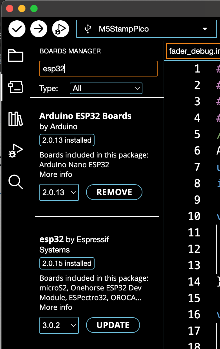

<img src="/assets/uploads/files/1719362806312-screenshot-2024-06-25-at-8.45.59-pm.png" alt="Screenshot 2024-06-25 at 8.45.59 PM.png" class=" img-fluid img-markdown" /></p>
<p dir="auto">Try 2.0.15 for now until all the legacy mfgs (like M5Stack!) get on board.<br />
-Terry</p>
