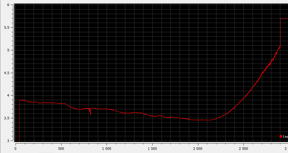

Here is discharge curve with 0.8V correction.<br />
Correction could not be done easily by substracting the error, because below Battery voltage 3.5V, measurement begins rapidly grow. Device stops work at 3.4V.</p>
<p dir="auto">It is difficult to name this device as a successful design.</p>
